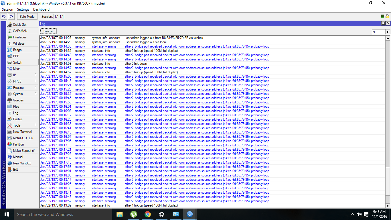

My RB750UP port 2 and port 3 poe out ok, but no data…Just want know what happen to this port…port 2 and port 3
As per screenshot below…what is the issue with the port…if can solve, how the process to solve it…

The description is quite obvious (is there a loop)
Without you telling us what is connected to the ports it is very difficult to tell what is going on.

For info…no physical connection connected/plug in to both port… port 2 and port 3…
As shown both port shown signage RS and link ok but no physical connection connected…

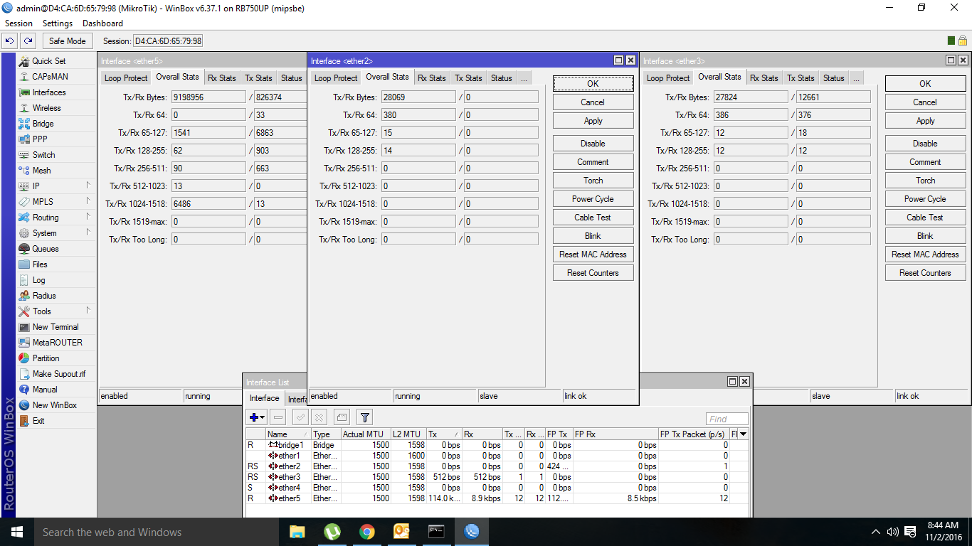

Even if I plugin direct from computer/device to that port, no data/can’t do anything i.e winbox of webfig…poe port function efficiently, can power up mikrotik device…
I would try to re-install RouterOS and if that doesn’t help I would contact MikroTik support or your supplier because I assume it could be a hardware fault.
