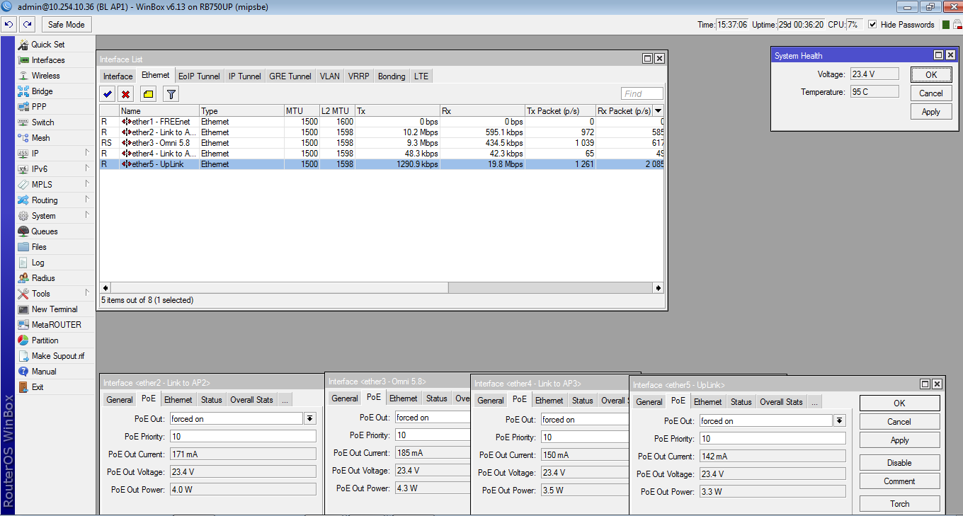

I’m using around 30 of RB750UP for small BS(powering uplink and 1-3 omni or small sectors. UBNT Loco). I’m using OSPF+VPLS for tunneling clients so for CPU usage its no big deal for 750s.
In last month after temperatures go up, i saw sudden raise on CPU temp on 750UP. Its from 45-90C depending on how much sectors its powering and how much traffic it have. But CPU usage is almost the same everywhere and doesnt reach more than 10-15%.
What is the normal temperature for CPU, and is there some series that have temperature problems?

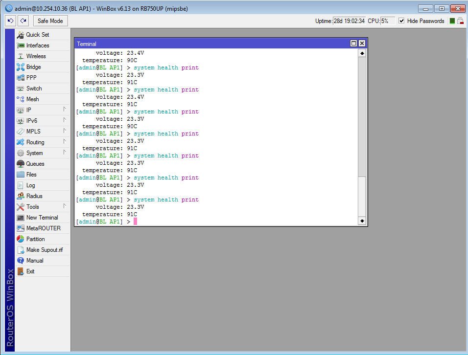

Here is same RB few hours later.

power usage and temperature your router is running at does not fit. Power usage most probably is correct one. However, if the device is running at that temperature, you should feel that when hovering hand near the device.

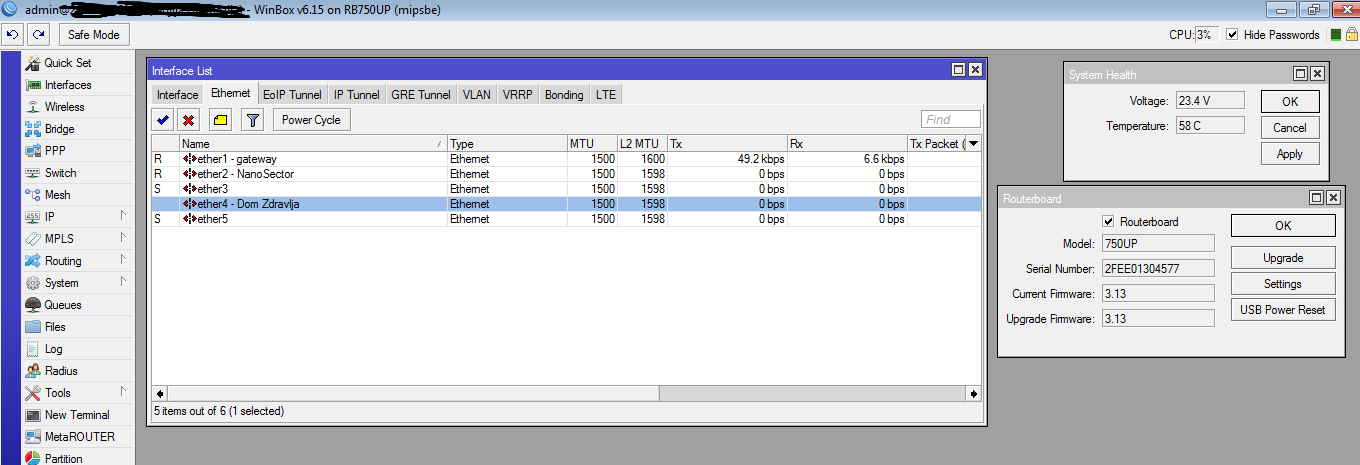

Yesterday I upgraded one of them which has only 1 device powering and it was 45C and after upgrade to 6.15 and firmware 3.13 it got warmer.

Over here 750Up is at 83. But strange thing happen few days ago and moments ago again. RocketM5 and NanostationM5 has been reset to default. At the same time! Any idea? Firmware is 3.13 and ros 6.18…

In the same cabinet 1100ahx2 is measuring 31C and 750up is at 80C. Nanostation is drawing 5W and Rocket about 7W. Cpu is at 15%. Defective device or something else?

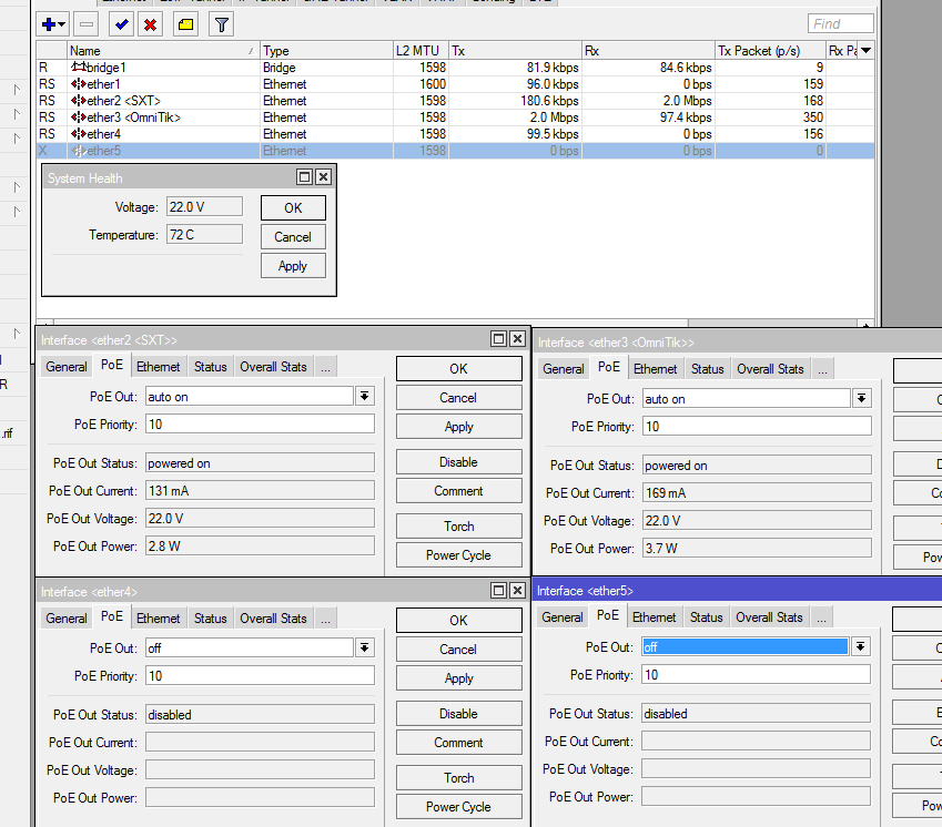

look at this picture
two units (SXT,OmniTIk) power consumption at minimum
its night outside temperature is around 15-16C
in a day time RB750UP can reach about 84C -outside temperature max 25-26C max and when I touch RB750 its not so hot its more like around 45C
