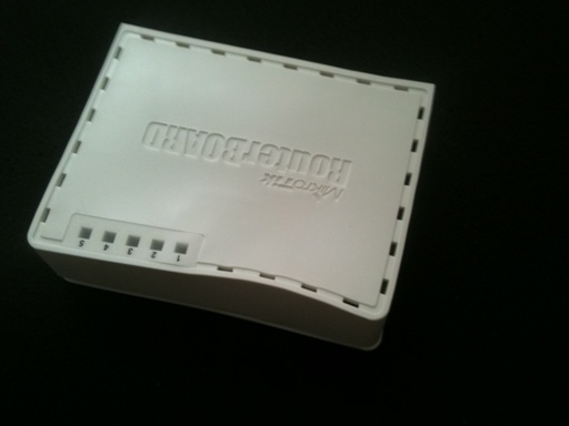

Please can you explain how temperature is measured on RB750UP (I think that measured values is not correct).
I can read with command that temp. is 43°C.
After applying hot air to board (plastic housing started to soften) I was able to read temperature 50-57 °C (and after reached 57°C the RB750UP was rebooted).
Touching board I believed that temperature is higher.
After this I put RB750UP in freezer for 1 hour (<0°C). Attached board to power, and to PC (board is staying in freezer). After 1 min I provided temperature reading and there is shown 38°C.
Touching board I believed that board temperature is below 10°C (or even 0°C).

Reading temperature on RB750UP means board temperature measured with ATTiny.
Please can you check values received with command “system health”, and real temperature measurements.
I made 4 measurements.
a) RB750UP at room temperature.
-Reading (“system health”) temperature = 43°C
b) RB750UP in oven with fan. Oven temperature setting = 50°C (15min).
-Reading (“system health”) temperature = 47°C
c) RB750UP in oven with fan. Oven temperature setting = 80°C (15min).
-Reading (“system health”) temperature = 54°C
  • see attached image => RB750UP is working but plastic case deformed.
    d) RB750UP in freezer for 1 hour (<0°C).
    -Reading (“system health”) temperature = 38°C
we will see to it. With holidays coming, most probably next year.
