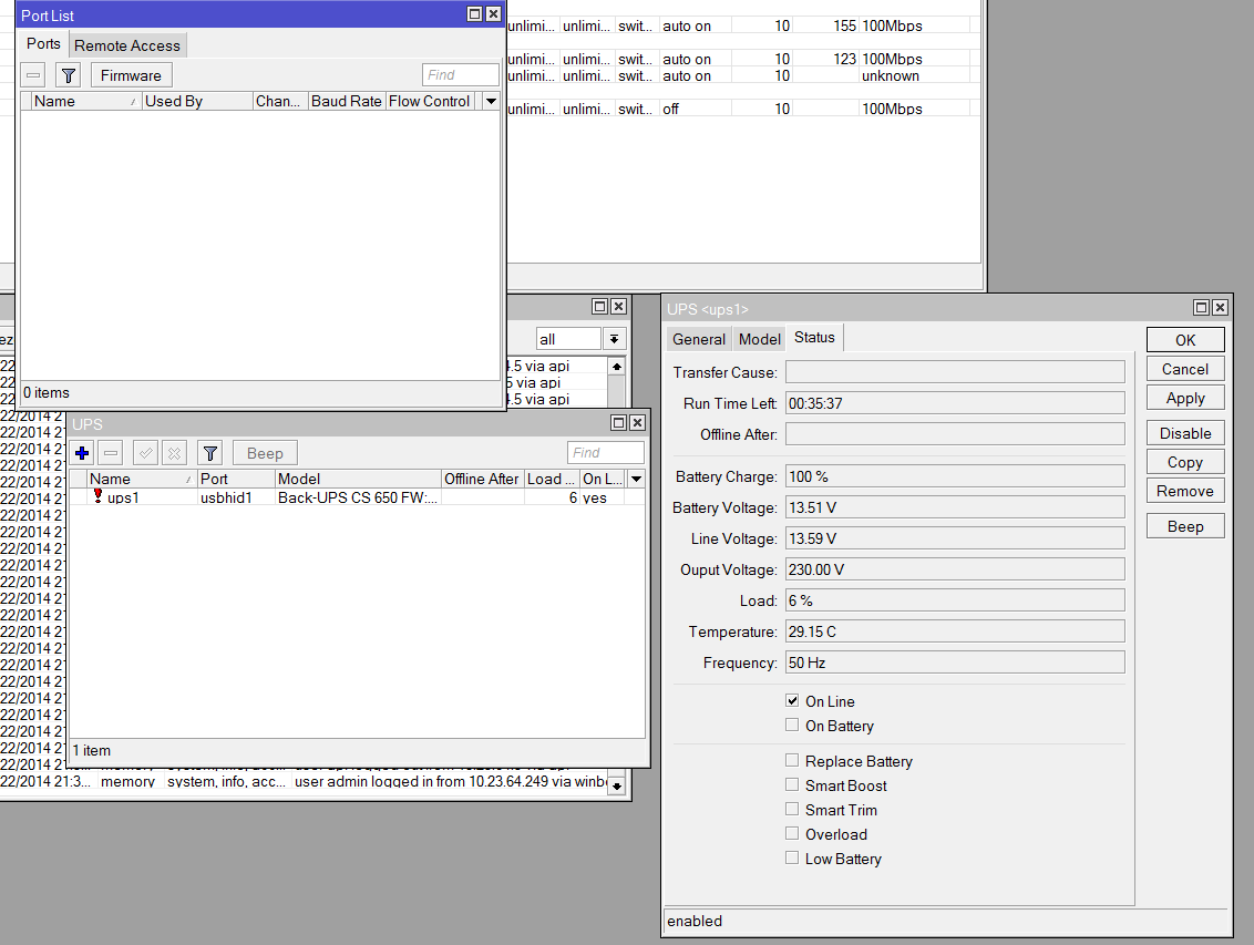

Try to add ups it is not need to seen in port if using usb ups.
Only APC ups are supported.
Here is picture from 750UP with APC Back-up 650 ups.
