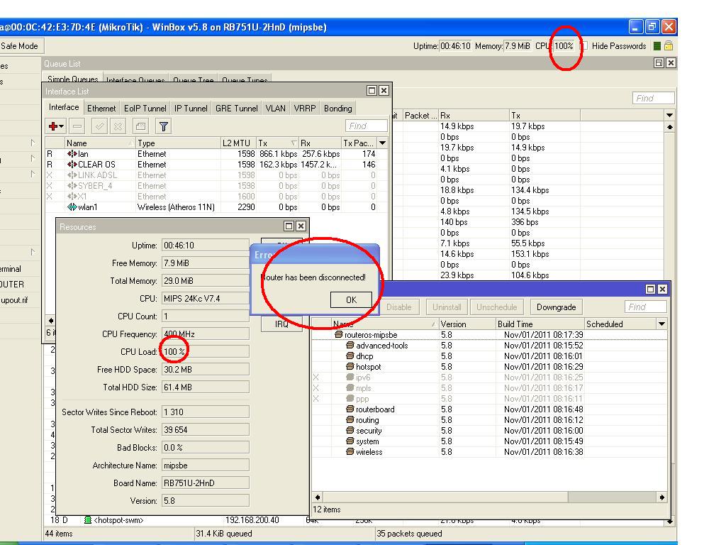

RB751 CPU usage get too high

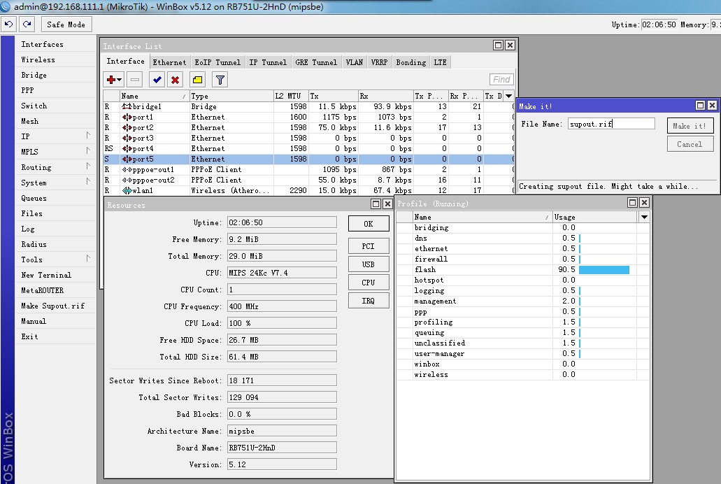

‘flash’ takes all available CPU,and last for nearly one hour
here is the .rif files i make when it happen

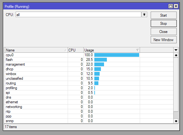

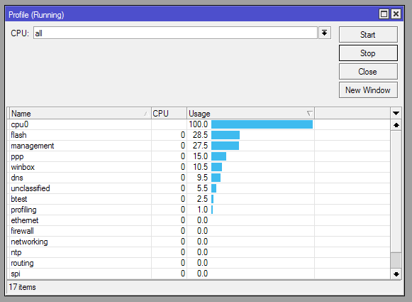

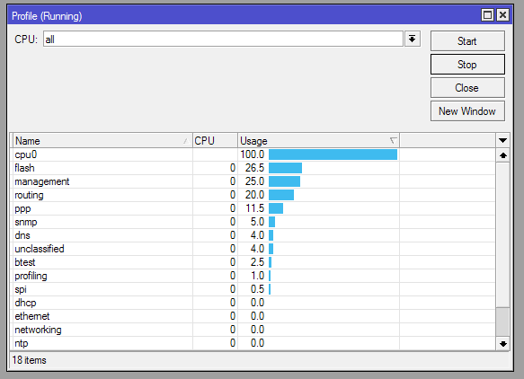

please check if it uses the flash without using the support output file generation - as the support output file generation takes a lot of CPU usage during the creation process.

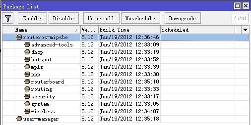

what packages you have installed on the router?
have you installed the usermanager or dude server?
Have you enabled or used the SMB feature?

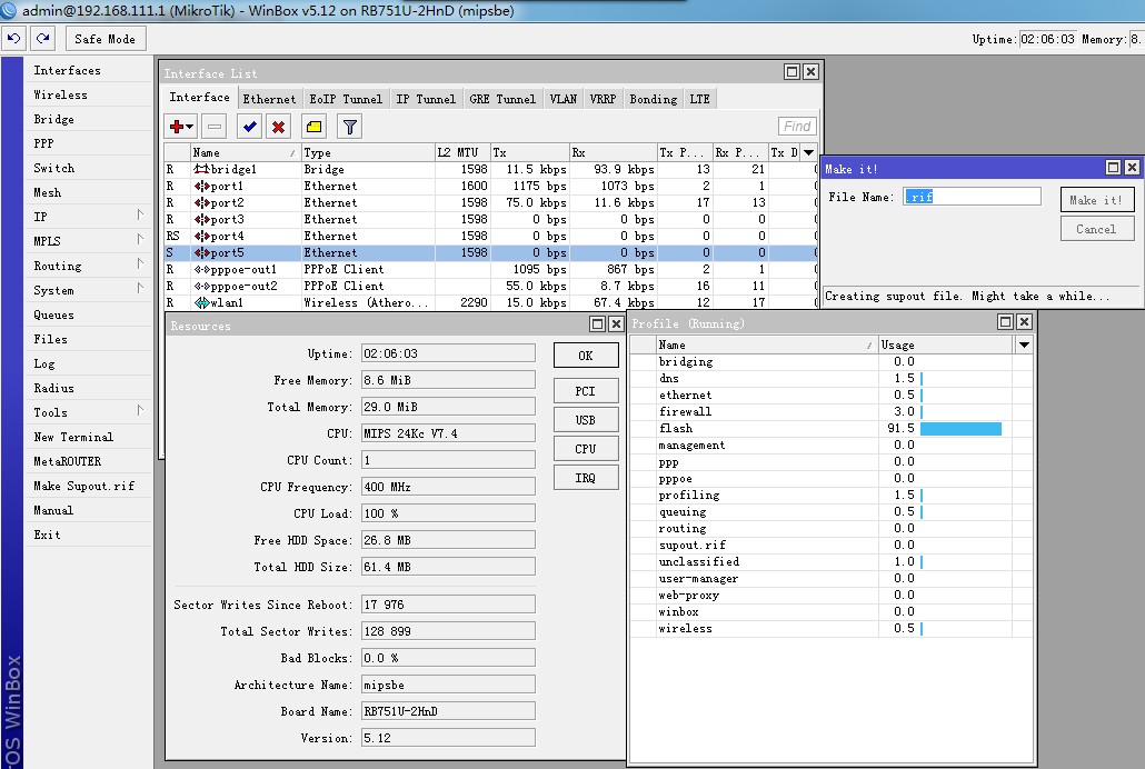

The .rif file isn’t fully created - you need to wait up to 5minutes till it creates fully and then send it to support@mikrotik.com
i don’t use the SMB feature and installed dude,but i installed usermanager,i need UM to manage user of the hotspot

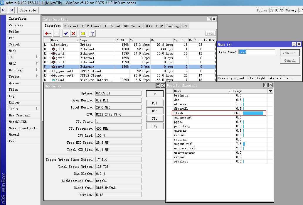

when the cpu usage get 100%,i make RIF file and wait a long time,but the winbox disconnect,i don’t know whether it creates fully create fully

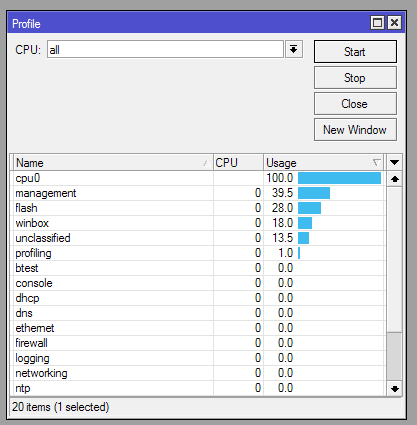

‘flash’ means ‘writing to disk’.
you are using user manager and you are making a supout.rif file, these two things use the disk, so this is normal. when you are not creating a supout.rif file, what is the flash usage then?
i know fiash mean the flash device read or write,but when there are not creating a .RIF file the ‘flash’ also get all the cpu resource
and the UM only has two users
MikroTik Support said
make a supout.rif file at the moment when “flash” is acting up, and send to support.
did you do that? if yes, wait for response from support. only support can tell for sure what caused it.
