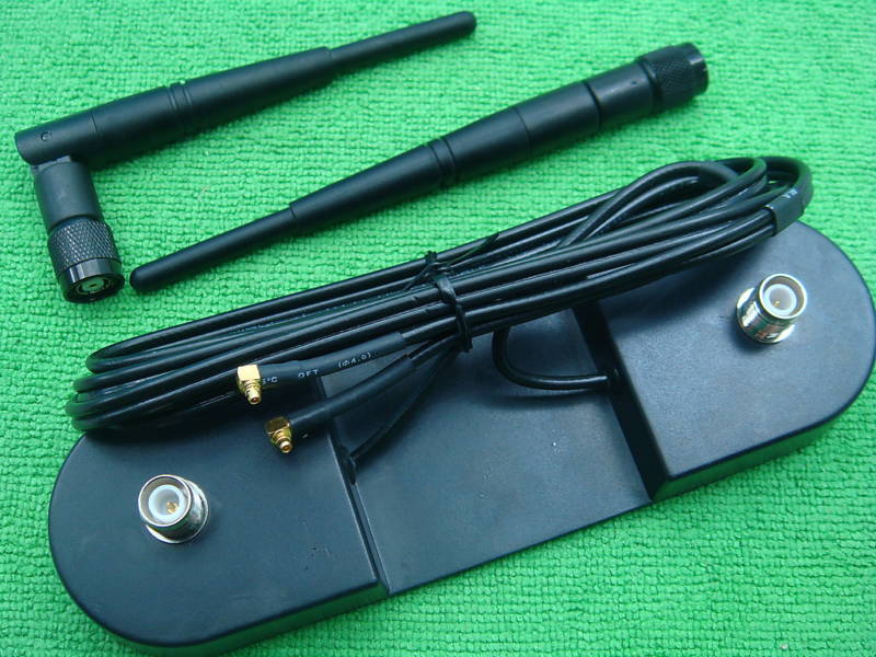

Will MikroTik sell external antennas for RB751, or is that something I have to buy somewhere else? Can I use this Cisco AIR-ANT3351? What I need to know is how many MMCX connector RB751 has.
Never mind, I purchased one and find out by myself. :slight_smile:
the normal MMCX pigtail can’t fit in the RB751 :frowning:
what kind of antena can stay there? or is only a joke
Only antenna with straight MMCX fill fit easily out of the box: http://www.google.lv/search?gcx=c&ix=c2&q=straight+mmcx&um=1&ie=UTF-8&hl=en&tbm=isch&source=og&sa=N&tab=wi&biw=1296&bih=1071
Sorry for a little bit stupid question, but - do I need MMCX male (http://www.ebay.ie/itm/SMA-male-plug-MMCX-male-plug-straight-adapter-/270680271717) or MMCX female (http://www.ebay.ie/itm/SMA-male-plug-MMCX-female-jack-straight-adapter-/280604128566) adapter? It is so small that I’m not sure, but it seems that RB751 has female and I need male, right?
It seems that neither of them will help me - I need “female RP-SMA to MMCX” to connect chosen antenna (http://www.dealextreme.com/p/2-4ghz-11dbi-sma-omnidirectional-wifi-antenna-47783), which I cannot find :frowning: There are only cables (pigtails), not adapters and I’d like to connect antenna without any cable. Perhaps I have to find an antenna with SMA (not reversed RP-SMA) connector :confused:
Well, not on eBay, but they do exist at least somewhere :slight_smile:
http://www.fab-corp.com/product.php?productid=16251
http://shop.cetacea.com/product-p/rp-3408-1.htm
http://wirelessconnect.eu/product/adapter_mmcx_to_rpsma_female

RB751G and RB751U now have extended MMCX connector, so no special antenna is needed.
What about those of us with an older model 751u, is there a solution for us to have an antenna?
That is good news but it would still be nice if Mikrotik carried an aerial we could buy.
I have fitted AC/SWIM to an RB751 but it is a bit ugly :slight_smile:
…and I thought that an antenna with mmcx connector should be considered “special”…
Most of antennas are rp-sma..
