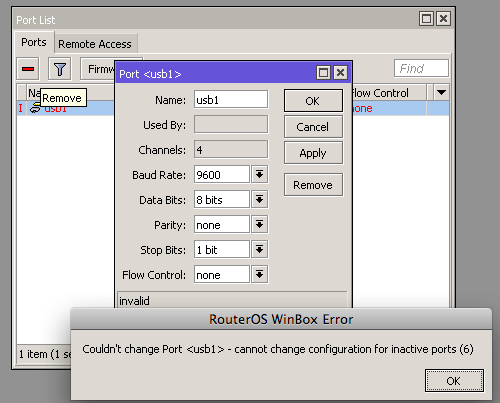

and on winbox, it says the port is not “inactive” but “invalid” although it might be a minor bug in the description of v6.15.
If I select the port on winbox > System > Ports > [select “usb1”]
and click remove, the port doesn’t come back on a reboot or hardware shutdown. I have to reload the configuration from the file system.
