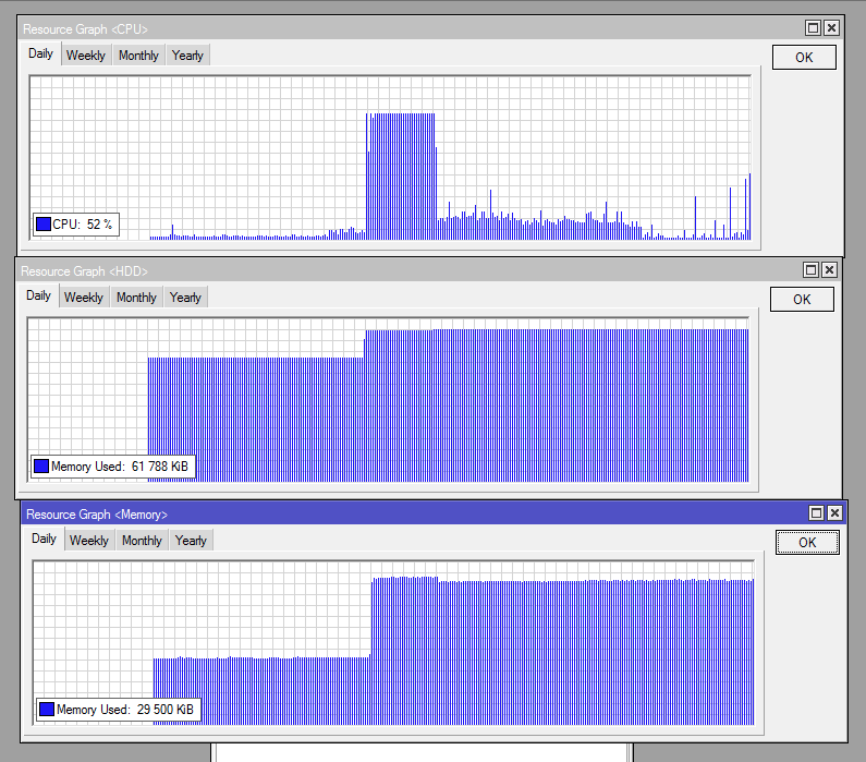

What is the cpu usage?

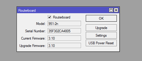

A couple of suggestions…
  1. Check the RB751 is running the new FW as well. In Winbox go to SYSTEM.ROUTERBOARD and see if you are running the latest. If not click upgrade and reboot.
  2. Try re-installing using netinstall and check the otion to “keep configuration”

Thanks for the replies. The firmware seems to be the latest, but the CPU, memory and disk graphs seem odd..?
Thanks,
Jeremy

Tools->Profile
