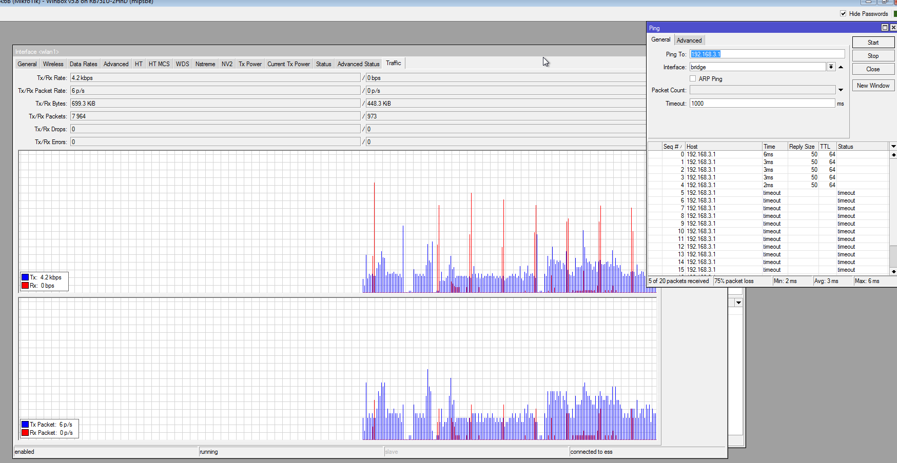

It worked for two days and now I tried to tune some values. After that wi-fi died. I reseted configuration but no luck - wireless connection established and Tx goes but Rx is 0.
I tried just station mode and Rx = 0. Should it move even if it will not bridge laptop request, right?
I managed to ping AP couple of times and that’s it. Result is attached.
I tried change channel width at AP again from 20 to 40, to Auto, tried BGN-mixed, G-only, N-only like in the first post and RB751 connects all the time but Rx rate is 0.
About signal: I took RB and my laptop and went closer to AP, to different places in the house but Rx is still 0.
CPU usage during speedtest was less then 20%, usual level is 7%.
Is it possible that receiver or one of the antennas is damaged?

make support output file during the time when it isn’t working and send it to support@mikrotik.com
