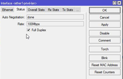

Control first your network cables.
Look to “interface” “status” for control your connection
