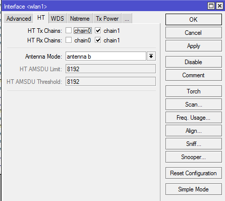

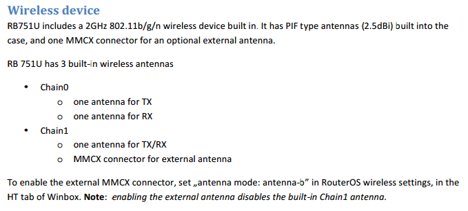

Here the configuration settings as told in the manual, my antenna picture and winbox config…
Antenna: 2.4 GHz 8 dBi TL-ANT2408C
Router rb751U-2HnD manual: http://i.mt.lv/routerboard/files/rb751U-2HnD.pdf
Why you disable chain 0?
Can/must be active at the same time.
Remember: more gain, more interferencies, more difficult the device on other side can be “heared”.
The wireless link are composed of two device, is perfectly futil increase only one side, also the other side must pass obstacles to reach the RouterBOARD.

I disabled chain 0 because it is what I understood by reading the manual and some other posts, but if it is wrong I have just re-enable it.
I understand what you wrote about “more gain, more interferencies”, the antenna I installed its a 8dBi one, so I thought giving it more power would make full use of it… correct me please if its worng.

Is of any use having an external antenna like the one I post here?
To enable it, I just have to set Antenna Mode to antenna-b?
Is it of any use having only the external antenna as rx/tx or do I have to use always the built in antenna?
What is the use of the external connector?
Only if on other side are present one repeater…
Yes, as on the manual
The scope are for use it like one Point-to-Point between two devices…
To attach external antenna…

This is an old thread but I was setting up an rb751u for wireless link with a yagi antenna the other day. Having both chains enabled really killed performance. I was getting a patchy 2Mbit/s with both enabled and this went up to 20+ with chain 0 disabled. I was also able to get a couple hundred meters where before the 200m link was unstable. For the 200m link I had one of the yagis pointed in the complete opposite direction (I can only point it at one repeater and there is another in the opposite direction.
