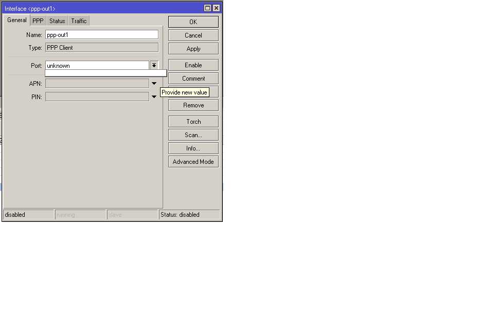

When I try add a PPP Client (ppp-out1) the ‘New Interface > General > Port:’ menu item is highlighted blue and the only available drop down item is shown as ‘unknown’, I cannot select usb3 (which is what I think it should be.)

Screen shot of interface;
