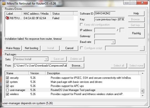

Had similar problem, but mine is that the lights does not come on wen it powers up, but with netinstall, it shows error as the led light will light and reboot, then the whole lights will flash again and the connected port will come on, repeatedly.
This is the diagram of what i see when i tried using netinstall.
