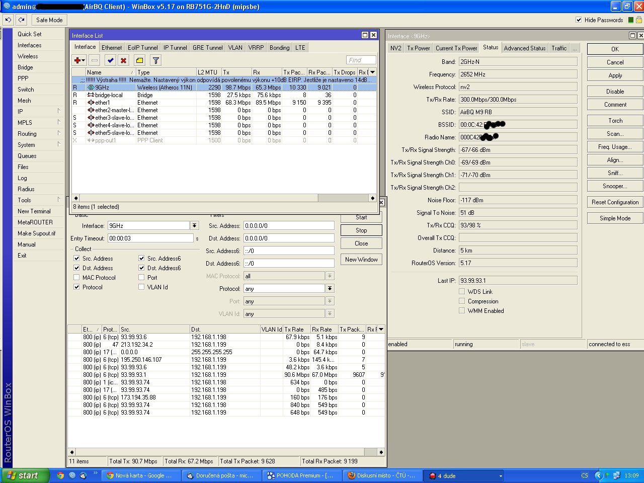

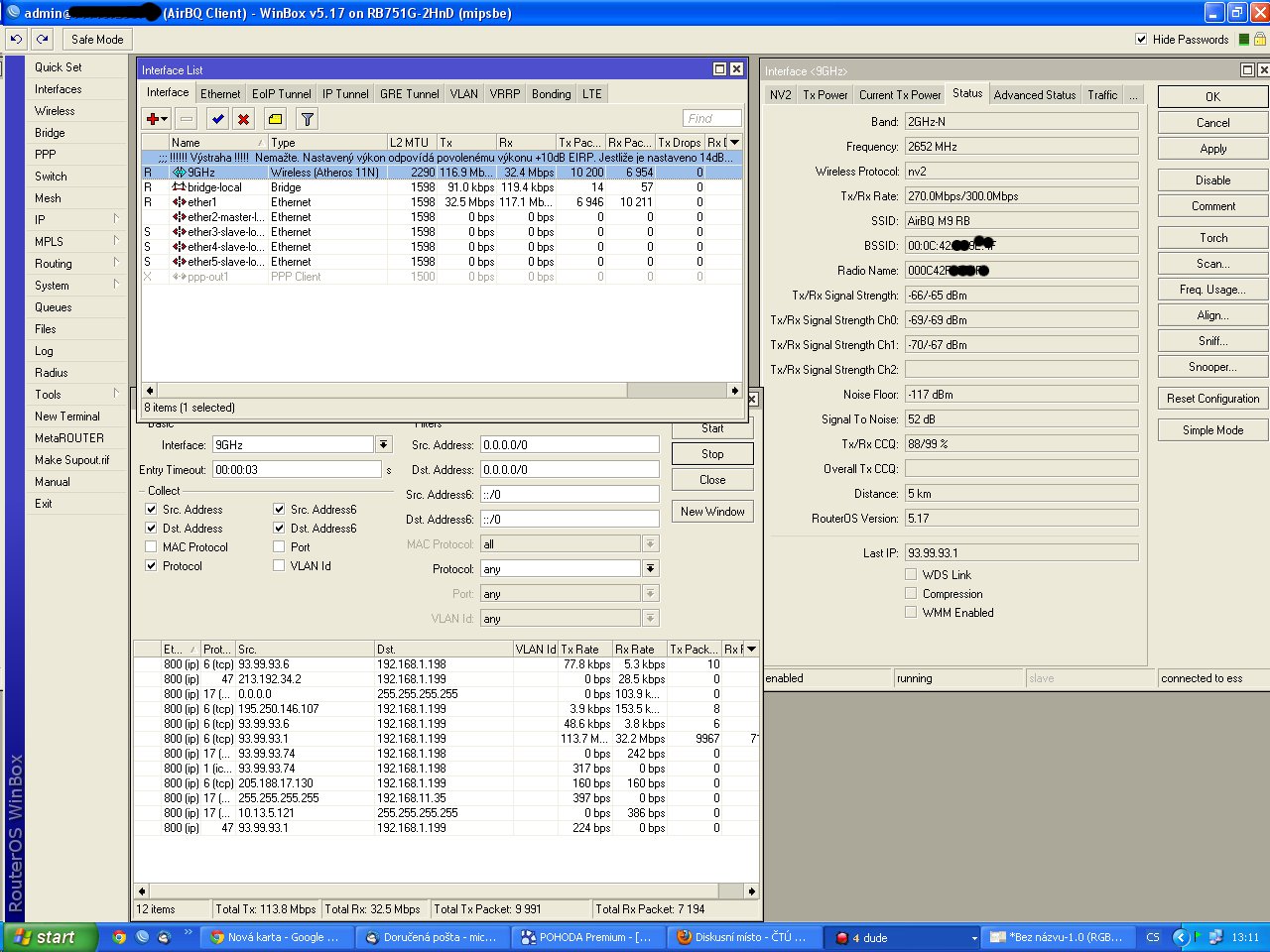

I mean RB751G is excellent piece on hardware and everybody accounts on working range about 100-150Mbit max. As we are using clear sky, links are able go on its best and it becames very tired about trhuputs of 180Mbit (CPU 90percent) We clearly know that ceiling is 230Mbit with RB751, but matematicaly 245Mbit. If I would use 60MHz, it it will be nice client, but for AP there is no suiting HW.. Orrrrrrr, is there any foreview for more powerfull PRO HW?

I will post some pics to describe what I mean, and what it can mean for Mikrotikis in future..
