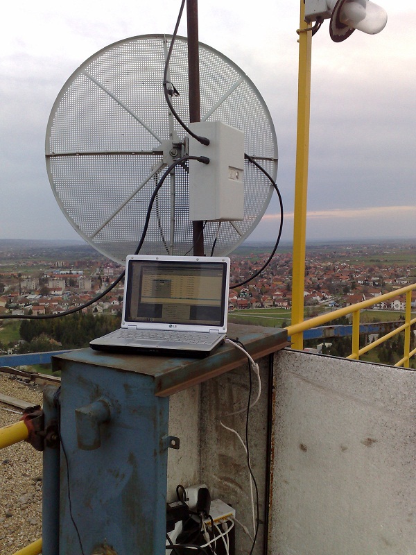

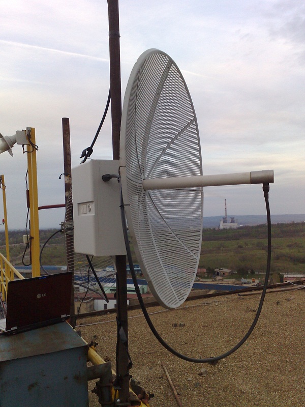

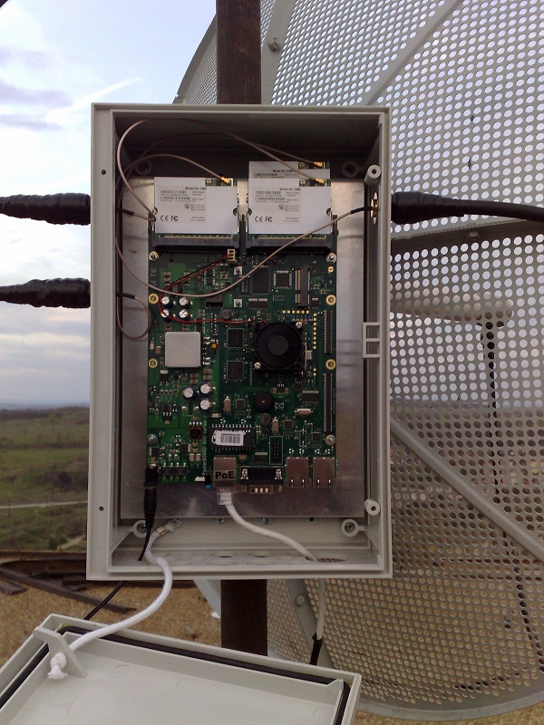

  2. We changed alloy box for plastic case on the pictures bellow. We changed power supply from 48V to 24V and not we are waiting to see if this is the problem.

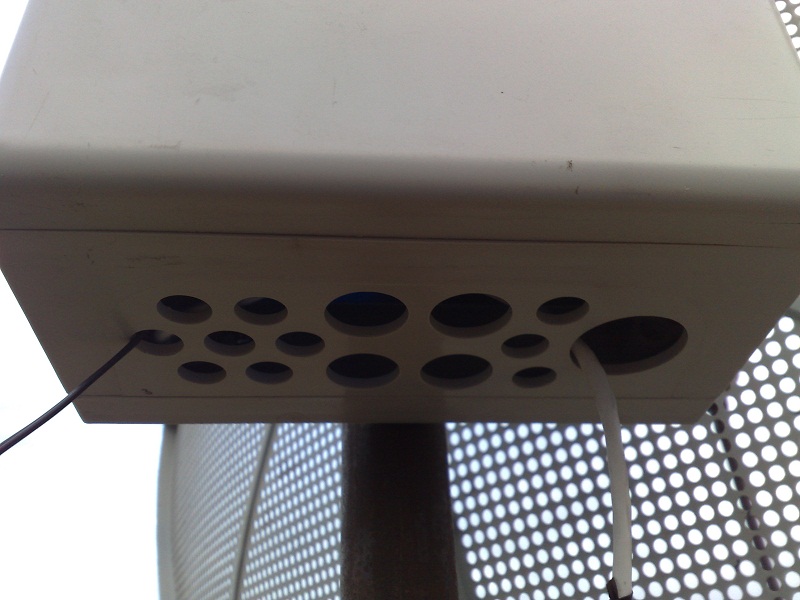

We completely removed rubber from the bottom to get better cooling, but we have to resolve this before snow, I supose snow might get in (with help of wind) through these holes.
This metal box (marked red) is very hot. I forgot to mention that we have tried PoE with two different 48V power supplies and we tried direct power with 48V and now with 24V supplies. We tried to put power supplies before and after UPS and it’s all the same, still hanging every day. This is electrical plant quite difficult to climb :frowning:

Are you sure you are supplying enough power at the other voltages? The XR5’s each use 1.8a max at 3.3v. That is a total of 23 watts. Add 9 watts for the RB800, and you are at 32 watts (24v@1500ma power required). Check “/system health” and see what input voltage the unit is showing. Might want to check it as it gets near the time it fails.
Things will get hot inside that box with 32 watts in there.

With those holes in the bottom, don’t be suprised if you find a wasp or bee nest inside the box.
We opened these holes yesterday because we were desperate to resolve the problem. I am not worried about wasps now, I am worried about making this to work without locks. This is definitely temperature issue because it worked today without problems and it was cloudy and rainy today. And this is the first day it worked without problems.
Besides, this big metal box bellow also has holes and there are no wasps or anything. As I said, this is electrical plant, 86m high and there are not many insects at this height.
