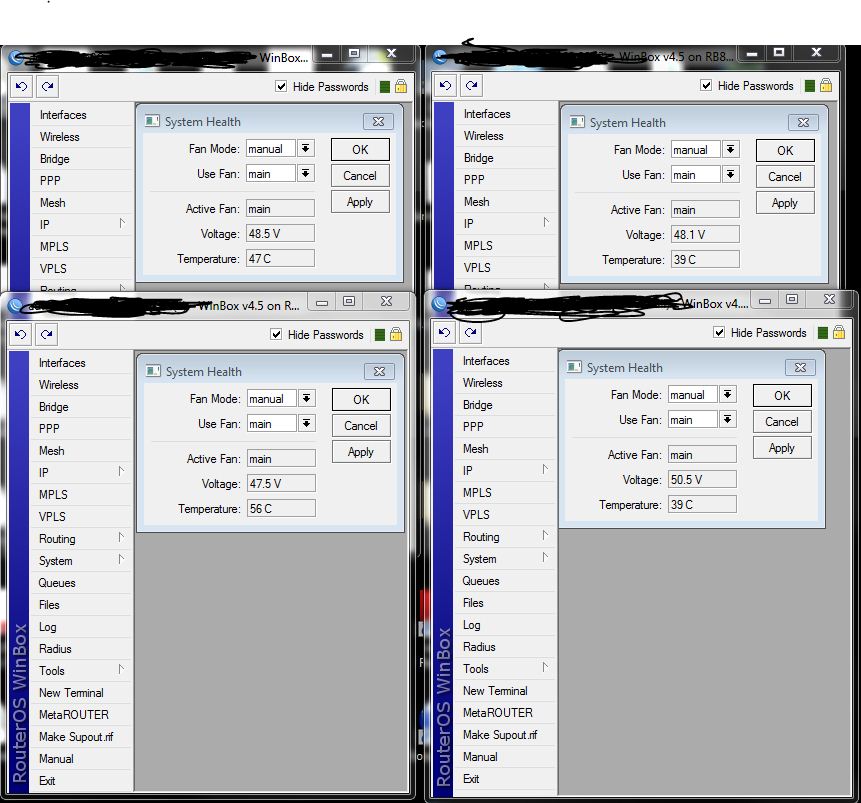

I have 4 rb800s lined up. No wireless cards. sitting in open air 75* f room temp. Same firmware. Right out of the box. Why is there such a difference in temps diffs?
Is the temp sensor on the cpu or just somewhere on the board?
RouterOS had problem properly displaying the actual temperature, upgrade to v4.9 and see then.
Yes, temp. sensor is inside CPU. Check your RB CPU load. On all RB800 CPU temperature must be very close.
I thought the temp issue was on other version’s of ROS (4.6) where it would just show 120c or something. Will upgrade all of them to 4.9 and sound off.
