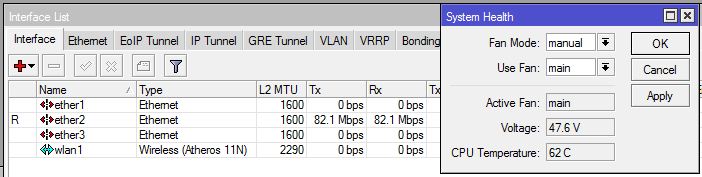

Just wonder know, in the system > health it’s show the CPU or the environment temperature?
refer to the RB800 tech spec, Temperature range -75℃ to +65℃, this is CPU or environment?
any issue with this temperature (attachment).
thanks.
thanks.
specifications talk about environment
RouterOS shows CPU
