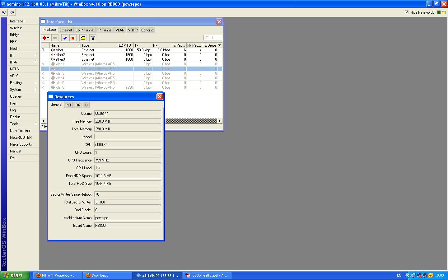

With all 6wlan disabled cpu is 0-1%

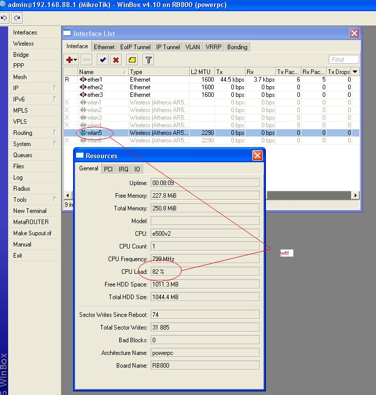

with 1 wlan enabled cpu is 80%

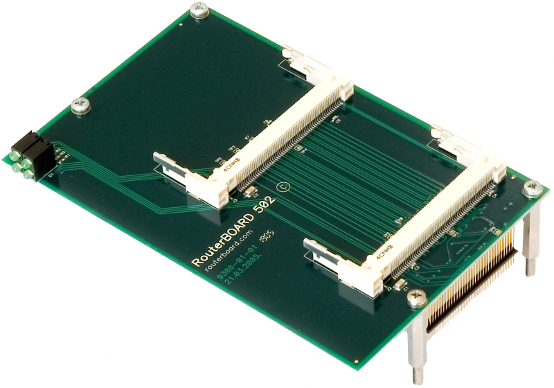

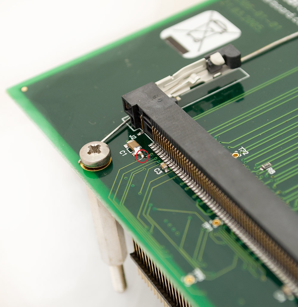

Yes, they are can be symptoms daughterboard connector malfunction. First - test all 4 wireless in RB800 without daughterboard device. If test success add full temp. fix and check is it your RB502 have this fix - see attached pic. All RB502 shiped les then ~one year ago have this fix. Old RB502 don’t have this fix because it designed work only with RB500. This fix improve mPCI stability to work with RB600/RB800 . Ignore the wire on picture - it’s just additional grounding, you need to look for small brown 1000pF capacitor. If you don’t have it put it like on picture.

with daughterboard only when I enable wlans on daughterboard in this case (like up in the pic) wlan5 or wlan6 CPU goes >80%
I’ll add extra capacitor like on the pic. u send, I’ll see what happens

I add extra capacitor like on the pic. but no success again when I enable wlans on daughterboard cpu goes >80%

If I have an older cards rb502 that dont have capacitor on picture, there can not be used in rb600 and rb800??? I have about 30pieces rb502 but they all look so…
Yes, without this fix with RB600,RB800 possible problem with PCI bus when daughterboard wireless is used. Just put it like on picture or contact with local Mikrotik dealer for assistance.
can i put different type capacitor than is in the photo ?
smt 1000pf not exist in the market here !
I have some old parts similar but do not know any code Capacity to find the right
