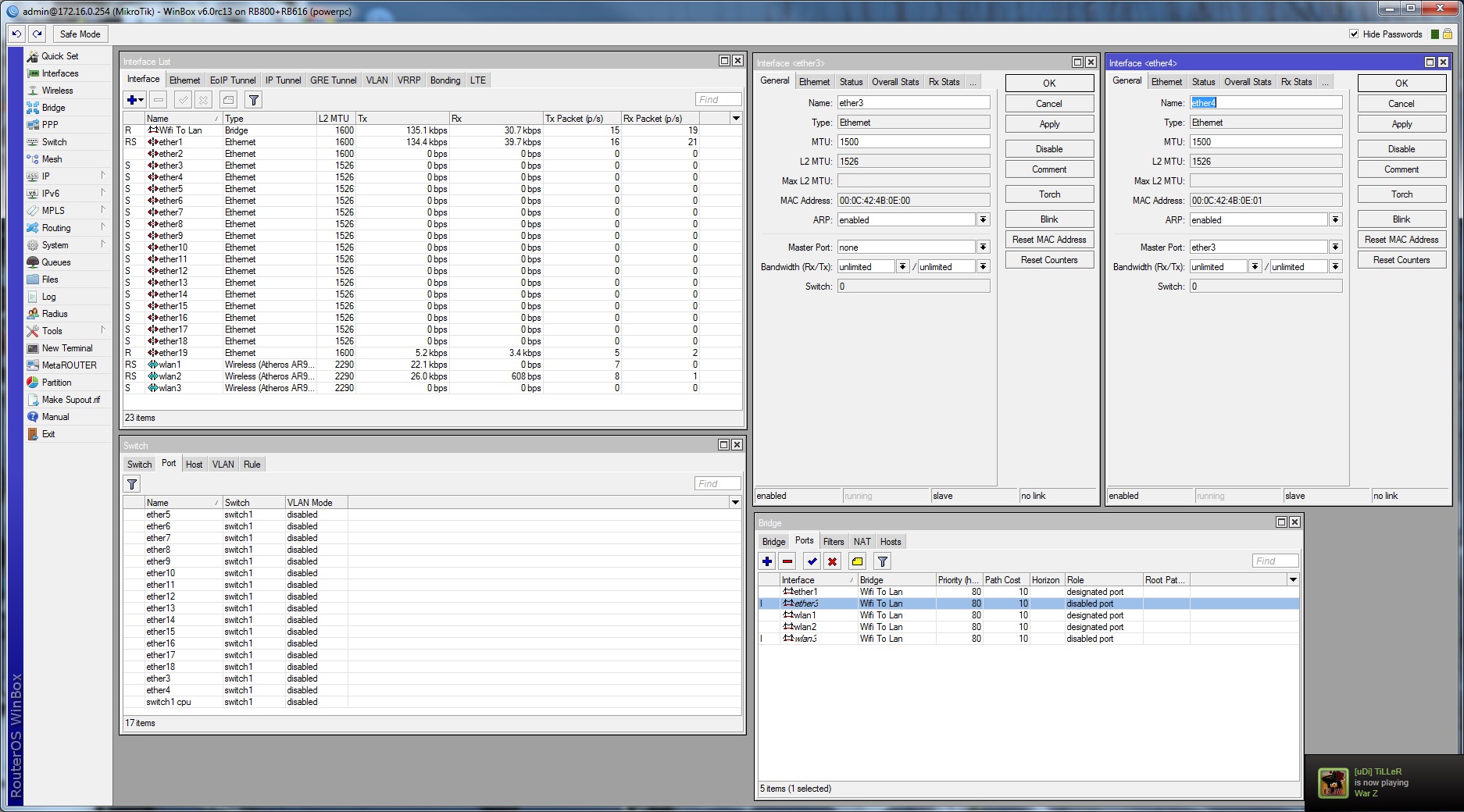

Ether 1,2,19 are on the rb800 board. Ether 3-18 are on the daughter card.
