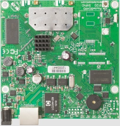

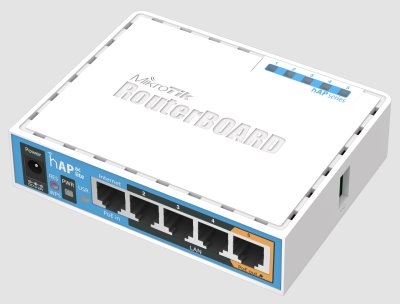

RB911G-5HPnD (2 x ant, WIFI4) VS. hAP ac lite (1 x ant, WIFI5)

Routerboard RB911G-5HPnD (2 external 5Ghz antennas, WIFI4, only 802.11n)
I’ll install 2 x pigtails with standard 10cm antennas
hAP ac lite (1 small internal 5Ghz antenna, WIFI5, 802.11ac)

Apart from suggestions for some more modern device … base RB911 is only a board. You need a case (list price $15), power adapter (price around $10), antenna pigtails and antennae them selves (price for all together probably around $20-$50). Which makes a notable price difference (and makes a “full” hAP ac a competitive option).

The hap AC lite is $59 (official list price).

The hap AC costs more than the Ax2, $129.
The issues with the hap AC (lite or not) are the architecture (MIPSBE) and the (too) little amount of memory (16MB).

I’m aware it’s just a board, but I have PSU, pigtails, antennas and box - so no extra cost there.
(by the way, get your pigtails and antennas from AliExpress at the 1/4 price)
