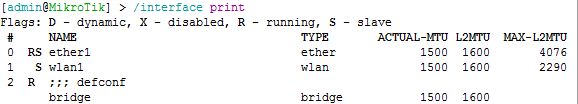

No interface was created for the device;
