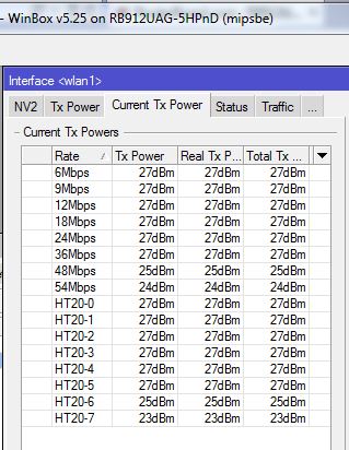

What is the real tx power of the RB912?

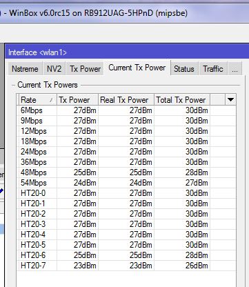

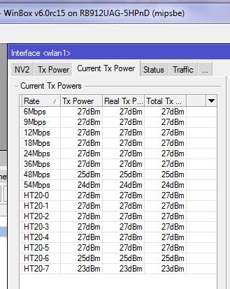

maybe if you enable second chain you will see the diference
Thanks, I had forgotten about it.
But, RoutersOs uses a strange way to show the tx power when using the two chains.
Yes, it is correct. Using two chains adds 3dbm. Or more correctly - disabling one of the chains reduces total power by 3dbm
