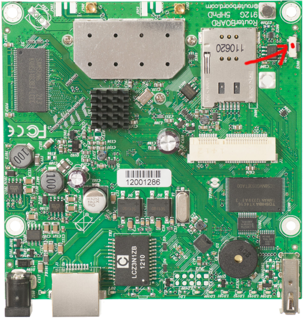

reset the routerboard with reset button, see picture a made
I tried but it does not work:
  1. Push the reset button
  2. Turn on the RB
  3. The LEDs illuminate ALL, then flashing, then turn off
  4. look up to when I hear a sound
  5. Turn off the RB
  6. Turn on the RB
  7. I don’t see it from WinBOX
Why?
