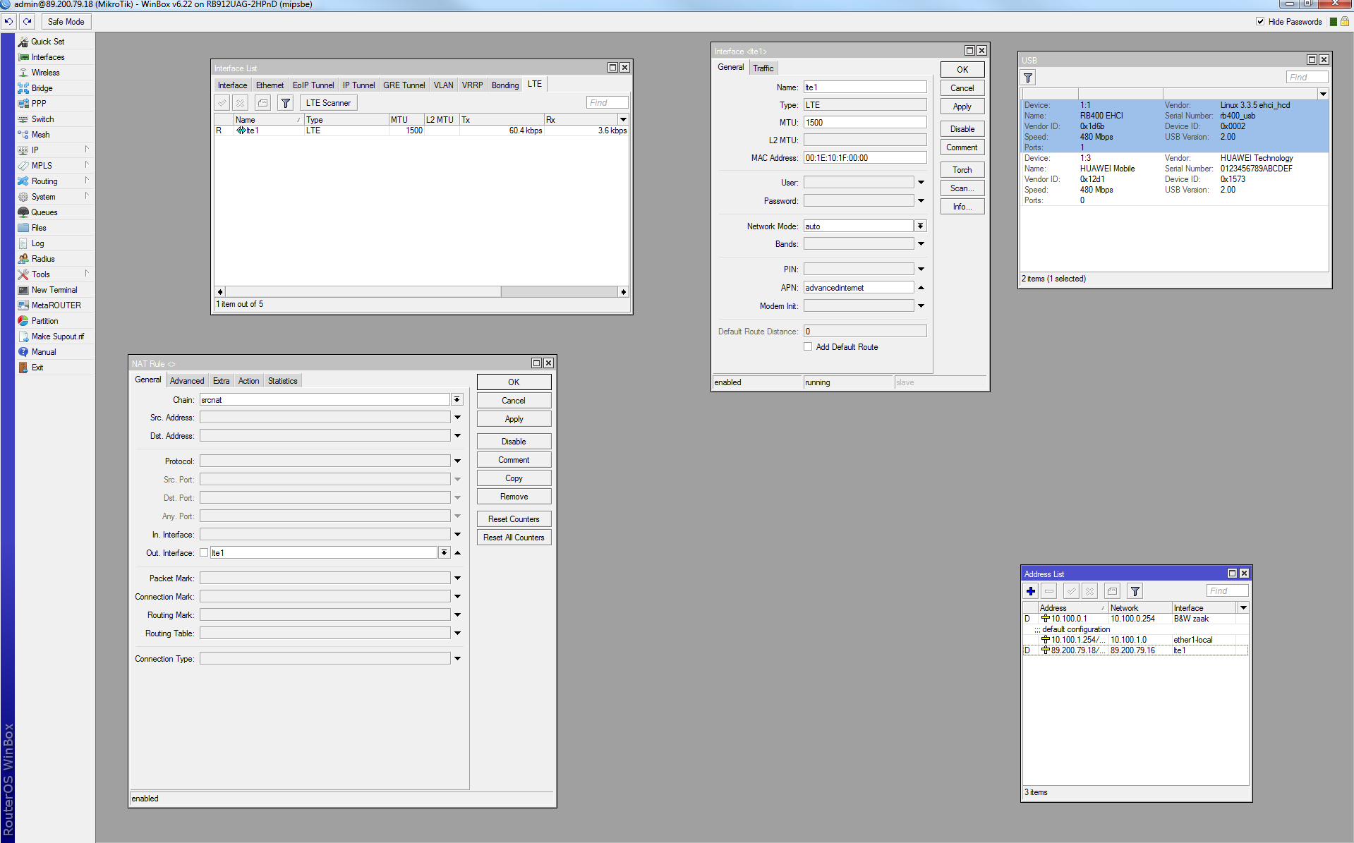

Hey guys,
This is my first time i’m using a LTE card, so i don’t know a lot about it.
But i got this thing working, but the internet is very slow (under 1 mb).
I’m running version 6.22
I’m getting an IP from the ISP and can connect from the outside
Does anyone has an idea what the problem can be?
[admin@MikroTik] > interface lte info lte1
status: call in progress
pin-status: no password required
functionality: full
manufacturer: Huawei Technologies Co., Ltd.
model: ME909u-521
revision: 11.234.77.00.00
current-operator: NL KPN KPN
current-cellid: 2995469
access-technology: Evolved 3G (LTE)
signal-strengh: -79 dBm
frame-error-rate: n/a
imei: 860461024084645
imsi: 204086597938089
rssi: -79dBm
rsrp: -109dBm
rsrq: -13dB
sinr: -1dB
Dennis
Try to check if the wifi antennas are not too close to the LTE antennas. Also try to change the position of the LTE antennas to get better LTE signal.
I don’t use the wifi, so i disabled it.
I try to change the position but i can’t get a better signal.
Should i try a other antenna?
I don’t use the WIFI so i disabled the interface.
I try to change the position but i can’t get a better signal. When i use my 4G dongle on the laptop i’n getting 20mb, so the signal should be ok on that spot.
Should i try an other 4g antenna?
