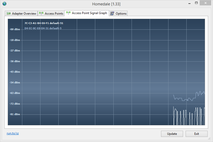

It was recognized correctly and seems to be running fine. Logs are crystal clear as well. However, the gain seems to be sporadic or intermittent. Please refer to the screenshot attached that shows the card running in parallel with embedded Atheros interface.

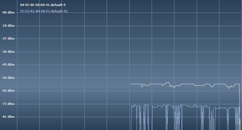

In the meanwhile, I have also tried a test by sitting closer to the AP. However, the result is similar:

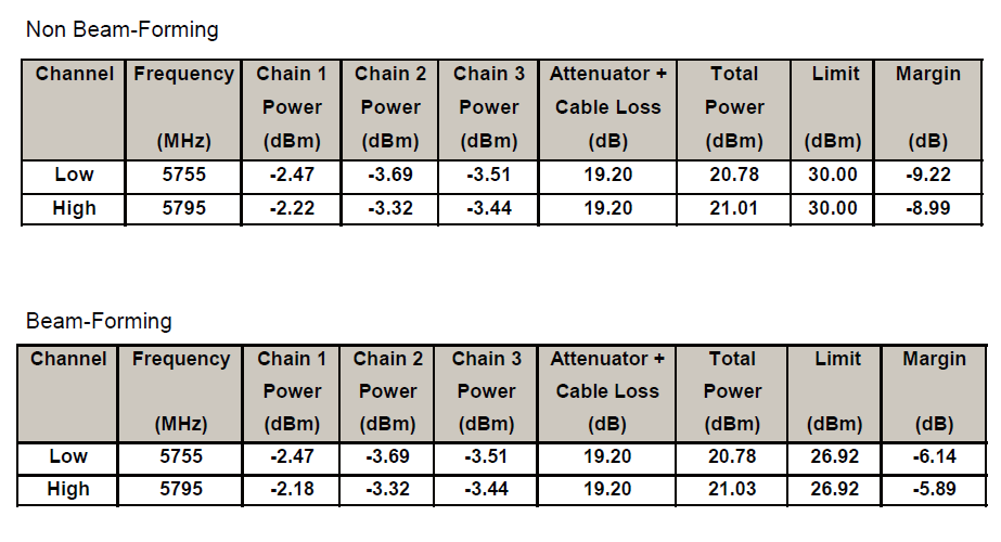

Here are specifications from FCC test report for this wireless card(PPD-AR5BXB112):
20Hz channel

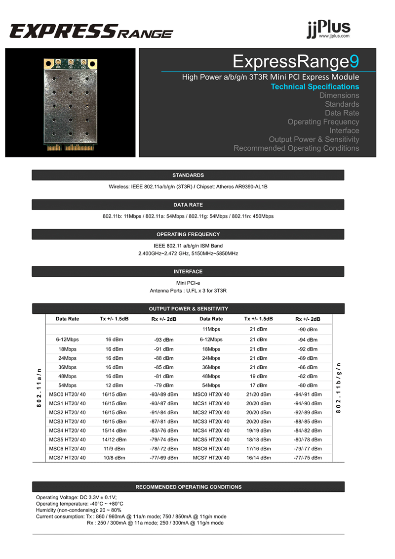

datasheet from the similar card:

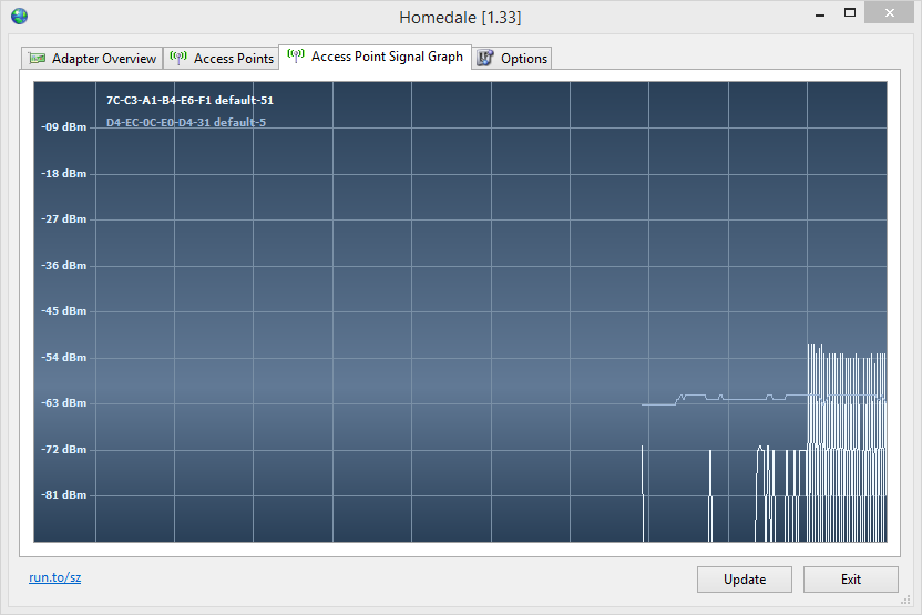

First I switched the card from 5ghz to 2ghz w/o changing SSID. Testing is done while being connected to default-5. No clients are connected to default-51. You may see this switch in the suden TX increase for default-51:
…continued
…continued

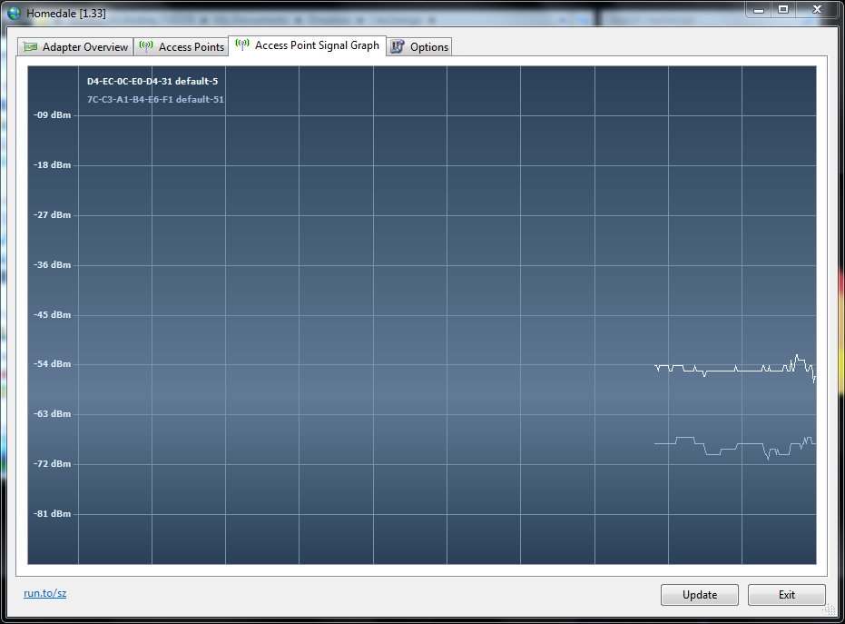

Next, I connected one client(laptop) to default-51. Tests are performed on the PC connected to default-5 still.
Finally, I decided to run the test from the laptop connected to default-51. In parallel, PC runs it’s own test and still shows diagram as above. But notice now that on the laptop the gain is quite normal!!!
So, how can this be explained? And does the card works correctly in the end or not?
