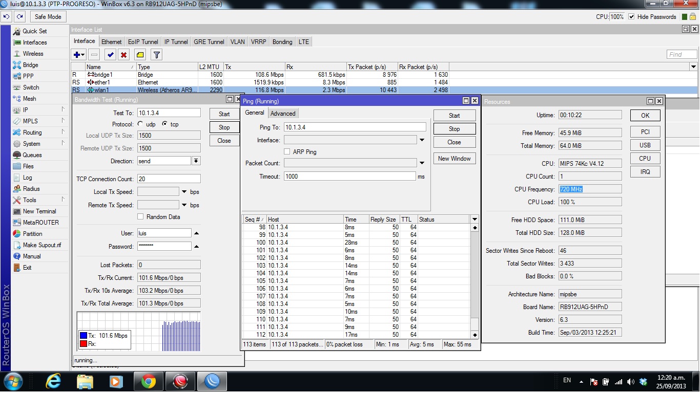

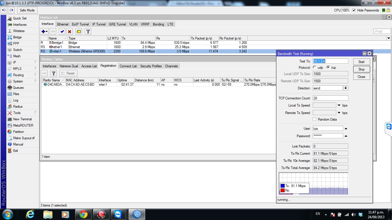

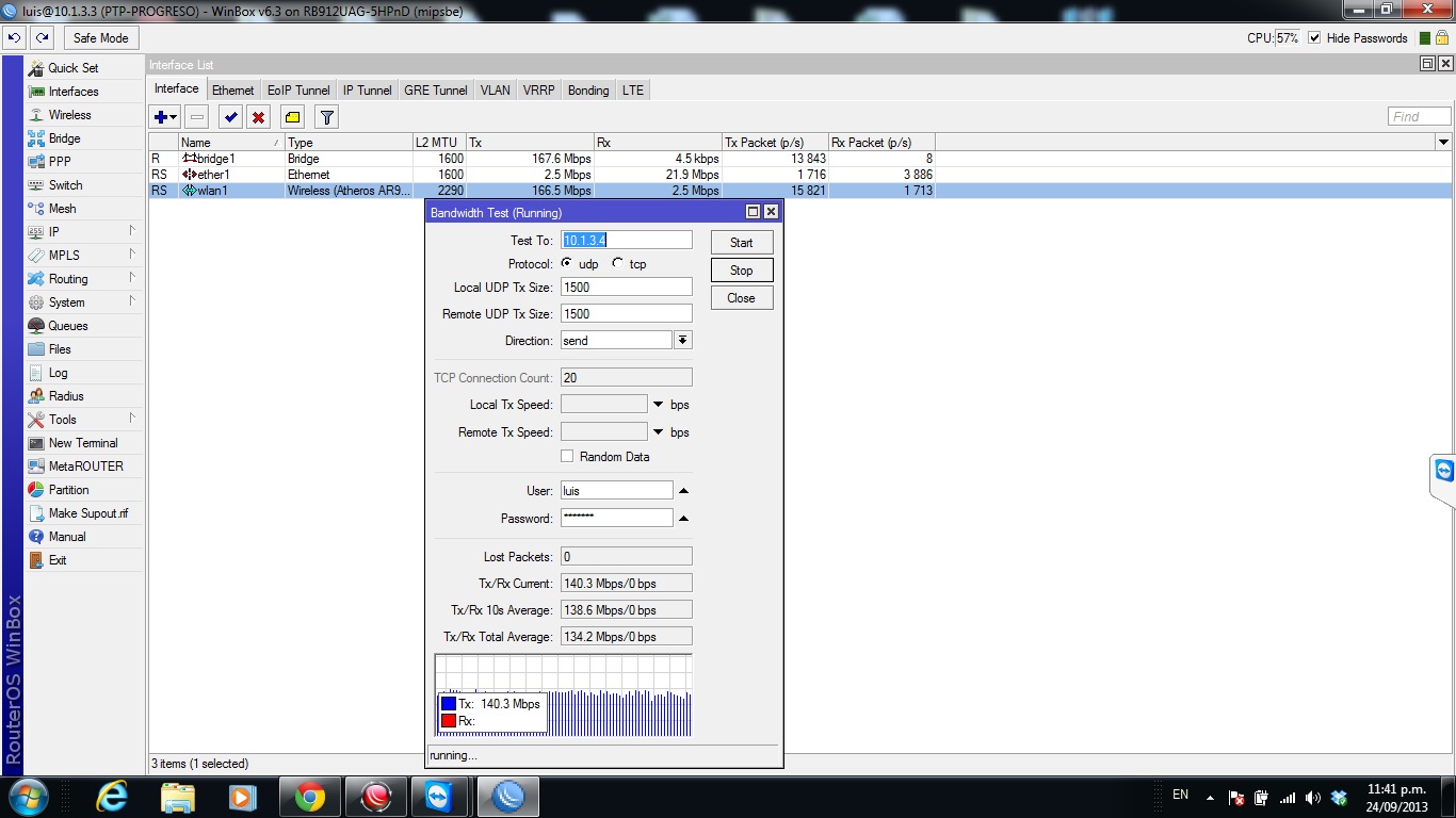

today received couple of 912 outdoors
here the results at 12kms.

now overclocked
Can i ask was the bandwidth test from RB912UAG-5HPnD to RB912UAG-5HPnD or a device before and beyond the RB912UAG-5HPnD pair?
Look at the picture. This is another speedtester who measures cpu instead of bandwidth.

Test from 912 to 912, no other equipment between them.
You should test as follows: connect on both sides of the link a PC to the Routerboard and run an Iperf session between them.
If you use btest on the Routerboard itself you are, in fact, testing its CPU and not the link.
Doing a TCP bandwith test on the router itself is very demanding for most routers. Running a bandwidth test THROUGH the router is far less CPU intensive and therefore a better test.
