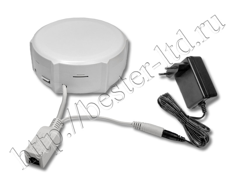

I was connected as shown in the image, but the power does not enter, it did not work.
That’ll sure do it :laughing:
Also be sure when testing that your Ethernet cable has all 8 wires connected (look at RJ45). Some inexpensive cables (shipped with cheap soho 10/100 routers for example) only have 4 wires so will not work for PoE.
I’ve tried the cable of category 5e something of this, but none was also no good.
In case anyone did not understand - the image is how NOT to connect the cable :slight_smile:
Power to Mikrotik is supplied via the socket connecter of the adapter using an additional RJ45 cable.
As you say, how to connect the cable seems to be bad.
