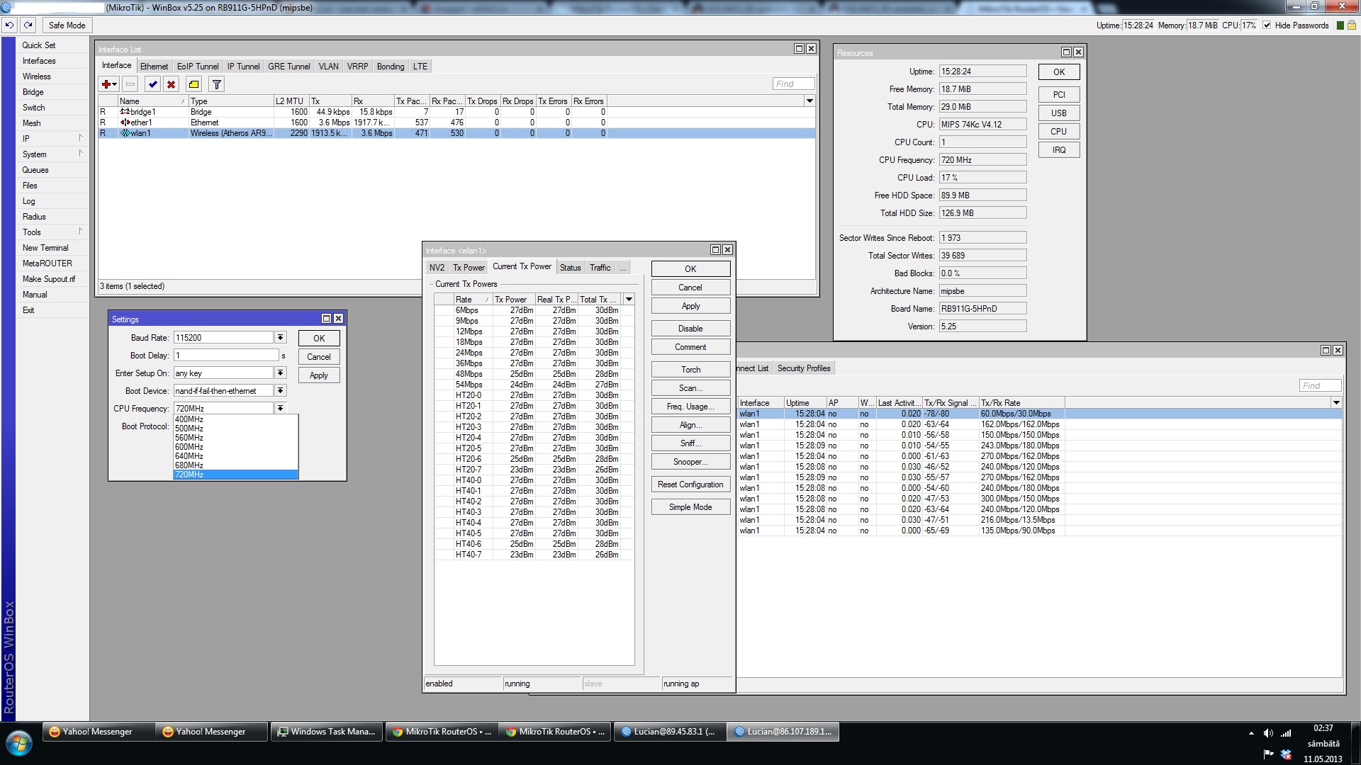

Thanks for the information Inox. I’ll probably just do the 912. I forget about toggling CPU speeds. If you toggle the CPU high, is that like overclocking? Will it increase the failure rate of the routerboard? Also does it still maintain the same temperature specs of the board? Or does the extra heat reduce the maximum temp range. In July, we can get up to 110F (44C) and inside an outdoor enclosure can get up to 135F (57C). Maybe someone at Mikrotik can weigh in on this? Normis?
Of course CPU freq upping will change the CPU temperature as well. Does it make it go over some limits, it is up to the experimenter to test or maybe the MT gods will set us straight.
Adjusting the CPU frequency is fine, but you must test it in your situation. For each install the result could be different. If you are in a cool area, and box is well ventilated, overclocking can give good results.
Thanks for the reply Normis. Due to our summer heat, I’ll probably just overclock on our indoor and climate-controlled boxes.

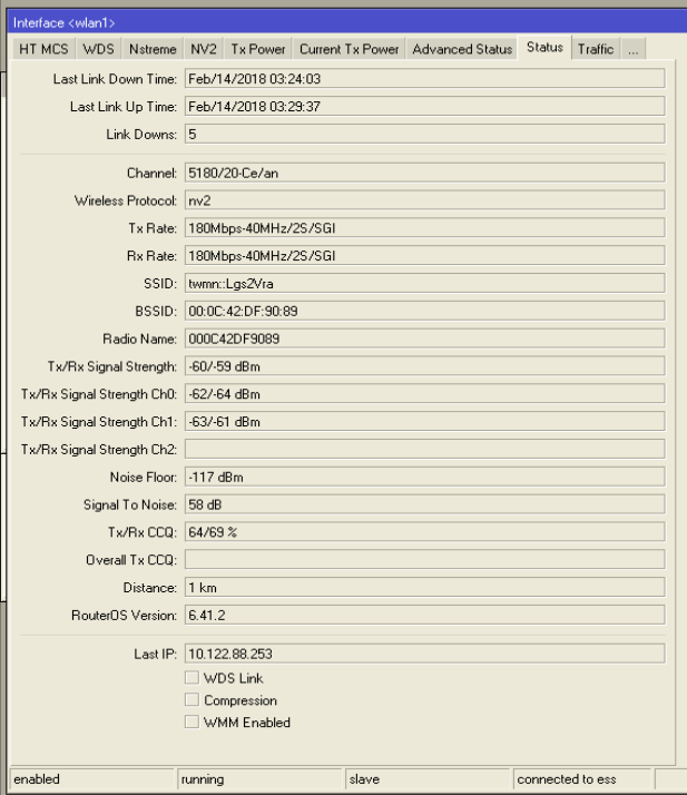

hello,
i see that you have clients connected at 270 or 300 mbps..
i have a pair of 912UAG-5HPnD and try to setup a wireless link..
Max. tx/rx rate is 180mbps (inside the house) max transfer rate is 80mbps
can you recommend me any settings to setup this backhaul link ?
