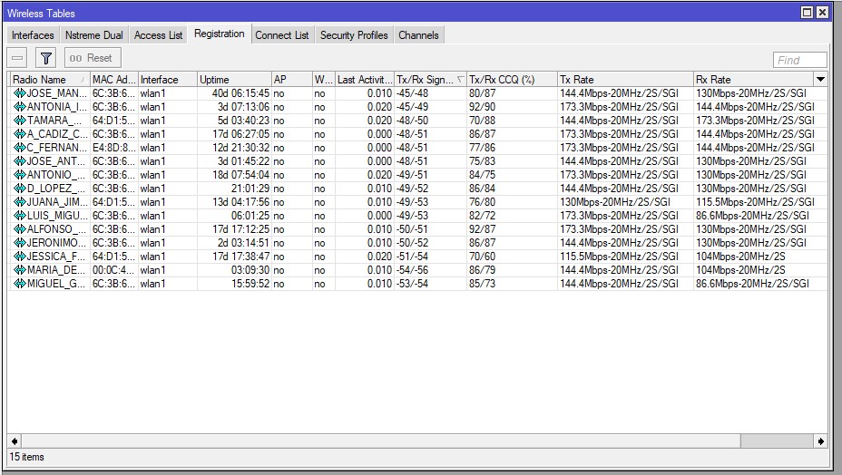

Hello this is my wireless registration
looks not bad at all, but it client how has 86 Mbit limits all other if he es transfer data…
just add ccq (click right on the arrow (down) and select ccq)

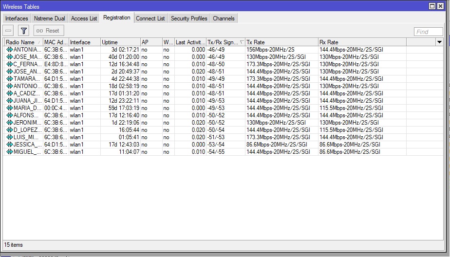

Hello, I enclose the image as you have asked me
What client devices you are using?
Sxt Lite5 ac?
What protocol? NV2?
Yes, and I used NV2
Do you deliver voice / sip service ?
If not try 802.11, for higher speeds
How to make this change? Is it done in the cpd part?
I currently have clients that have voice / IP but others do not … can I modify it in those that do not … or do they have to be all?
