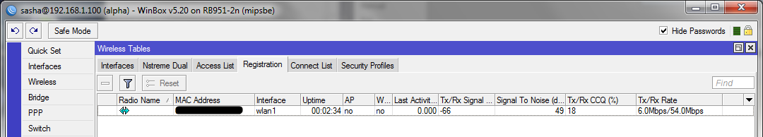

I bought RB951-2n a week ago and since that time tried to solve wireless issue: wi-fi station (laptop) very often lost connection or signal level becomes very low on station side, but normal from mikrotik device (see screenshot). I tried all combination: 802.11n only, g only, wpa2, wpa, without encryption - the result was the same. I don’t think this is a lack of ap power: distance is only 4m behind one wall. I tried to change a wi-fi adapter to external usb one (D-link DWA-140) also. The behavior is the same. Download speed is jumping from 100 to 600 kB/s.

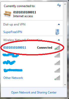

I am having a problem with my new RB9521-2n. The signal sometimes drops very low and disconects.
When i try to scan for other wireless access points through winbox (to set up the correct chanell), it shows just 2 APs, There is an other access point with “SSID:0101010100011”, its 10m away from the RB951-2n but it doesnt show that at all in the scan list, also i presume that there are more networks which it doesnt show. Why?
