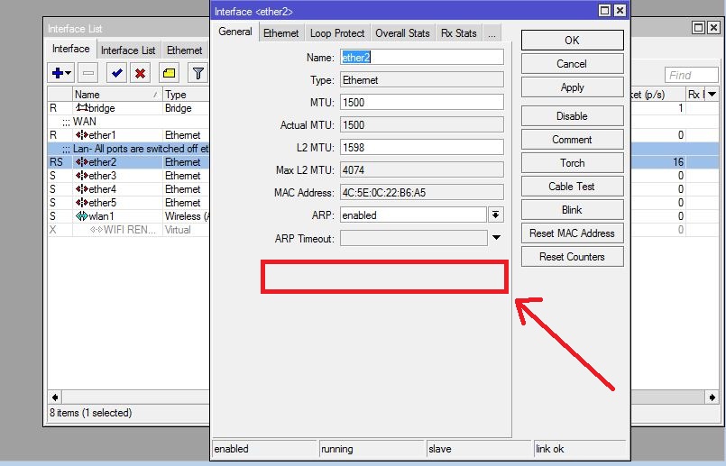

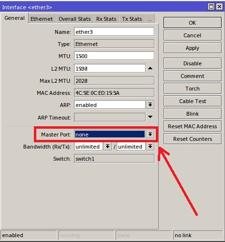

Hi Guys, im newbie here i just have a question about 6.41.4(current). where can i look the “master-port” option here at 6.41.4?
Please see attached file below screenshot using v6.41.4 and v6.41.3 .. thank you.
Up for this.. i hope you guys could help me..
Thanks and regards.

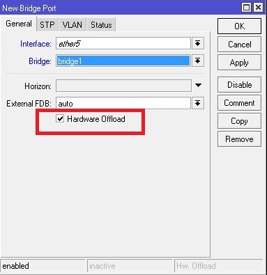

The concept of master port was removed, you need to use bridges now. If possible they will be hardware accelerated (eg as a switch group).
new bridge implementation that supports hardware offloading (hw-offload).
