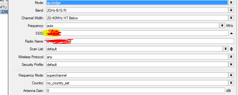

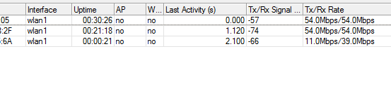

RB951G-2HnD 802.11n issue
I had set 802.11n only in MT router, My two phones TX(MT side) can’t reach 65M or 72M. and never see 802.11n rate.
please look at below picture http://1drv.ms/1jvP0VG
please look at below picture http://1drv.ms/1jvPsU5
same phone I connect to UBNT UAP-LR, it’s no problem. TX rate can keep 65M
please look at below picture http://1drv.ms/1oi3ppp
I think mikrotik with ROS is professional device, but I can’t find Greenfield relative settings in advanced setting.
any one know how to force 802.11n TX rate in MT side.
or help me find the reason why TX rate Limit by 54Mbps, never appear 65M or 72M
In MikroTik, that setting is referred to as HT Guard Interval and its on the HT tab. If you are still having problems, post your wireless settings.

Phones have only one antena (chain)
65-72Mbit if single chanel (20Mhz)
127-145Mbit dual chanel (40Mhz)
devices with 2 (antens) chains
can reach 275-300Mbit
devices with 3 chains
can reach teoreticaly 450Mbit
HT Guard Interval: SGI 400ns, LGI 800ns. it’s no relation with greenfield.
the greenfield is relative frame information. if set to greenfield the frame will not contain 802.11b/g require information. just use 802.11n frame.

maybe turning off Frequency Mode: Superchannel can help?
no, am swich superchannel for test.
