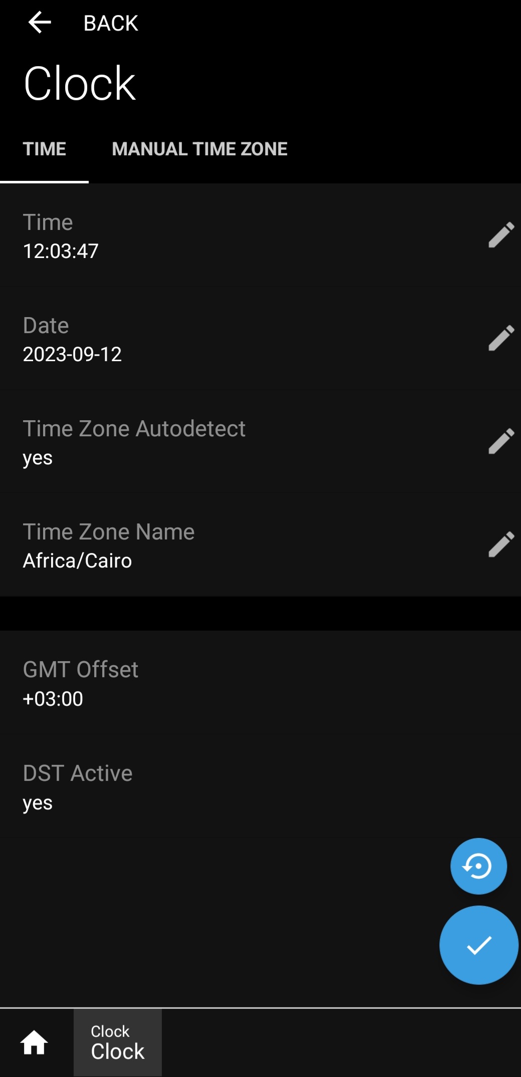

Rb951g-2hnd clock is not right
I try to adjust it manualy many times
Even date is wronge
But when power off it reset clock
I am not using ntp server or client
It should read clock from internet. Is it right ??
Not unless you told it to do so.
Ntp client or ip cloud time.

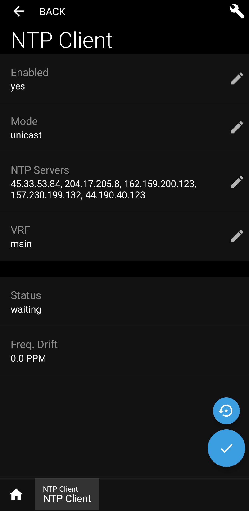

I try cloud timd and ntp client but it is not working check photos the date is wrong and time is manually entered
I noticed one thing when I enter clock menu the date shows correct for less than second then changed to wrong date ( decreases by 5 days ), also ntp client keeps invalid address for host name until I add ntp server ip
I do not know what is the problem ??
Maybe best to export your config.
Looks like neither IP/Cloud nor NPT client can get out so something is blocking on firewall.
But I saw another post of you where it might be hinted someone has access to your device ??
Netinstall first then !

/system clock
set time-zone-name=Africa/Cairo
/system clock manual
set time-zone=+03:00
/system leds
set 0 interface=wlan1
/system note
set show-at-login=no
/system ntp client
set enabled=yes
/system ntp client servers
add address=45.33.53.84
add address=204.17.205.8
add address=162.159.200.123
add address=157.230.199.132
add address=44.190.40.123
/system routerboard settings
set auto-upgrade=yes

OK, so you have NTP client configured. And nothing should be blocking UDP traffic with DST port 123 towards internet.
What does /system/ntp/client show?
Anecdote: a short while ago I added a new switch into my network … and NTP clients on ROS (and Linux) had problems synchronizing time to external NTP servers. It turns out that switch (which is a normal L2 managed switch) has some “Security” features … which blocked NTP traffic when “client” also used privileged port (UDP 123 is standard fro NTP). After I disabled that BS of a security, things started to work again. If client used non-privileged port (i.e. random high number), then it could get synchronization data just fine.
Meaning that you should check how NTP traffic is handled by upstream devices, most likely that means your ISP.
the status for /system/ntp/client was waiting
but today I check it becomes synchronized
And dat and time becomes right
I do not do any thing
