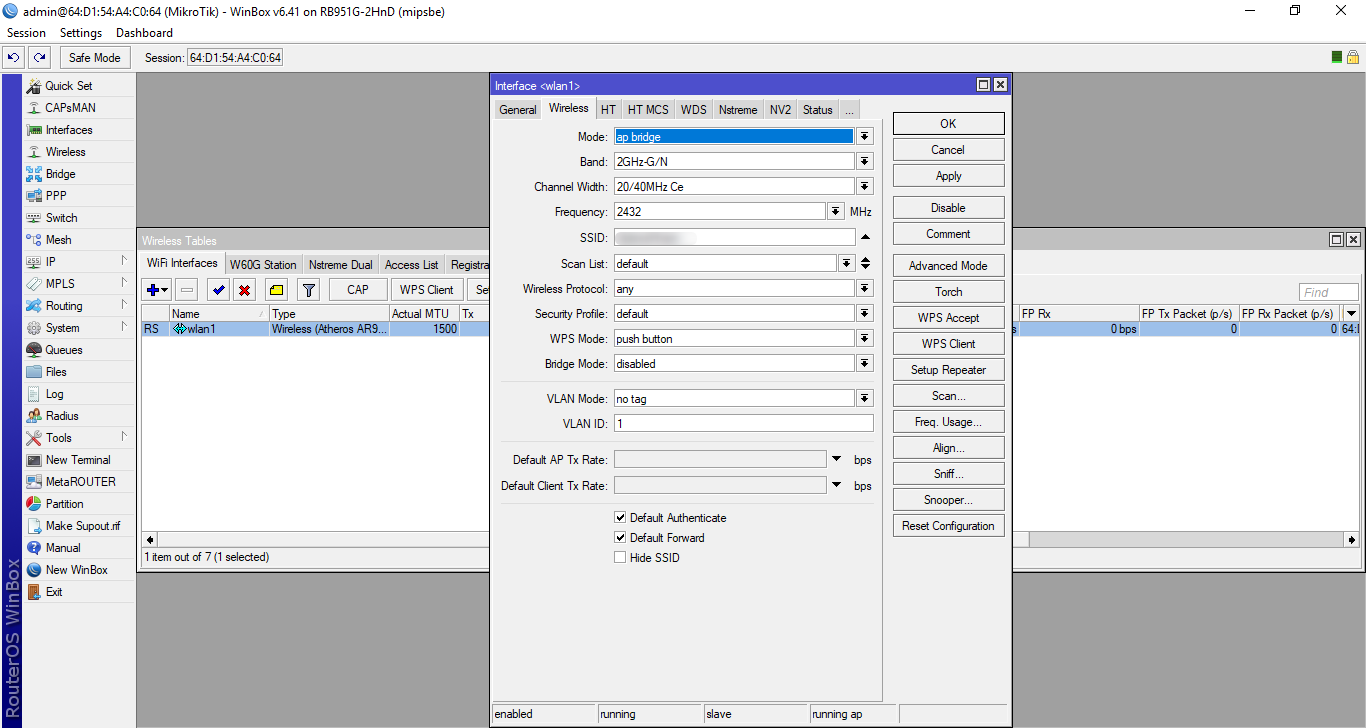

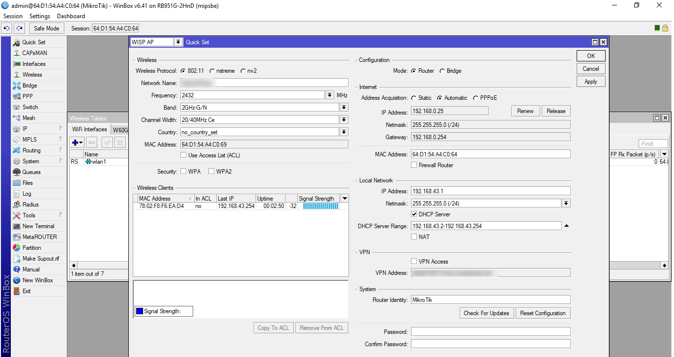

Since there is no need for anything special except to use the WiFi for several users, I did it with quick set, with Home AP mode and WISP AP mode. Yes there are other 2G band networks in my neighborhood.

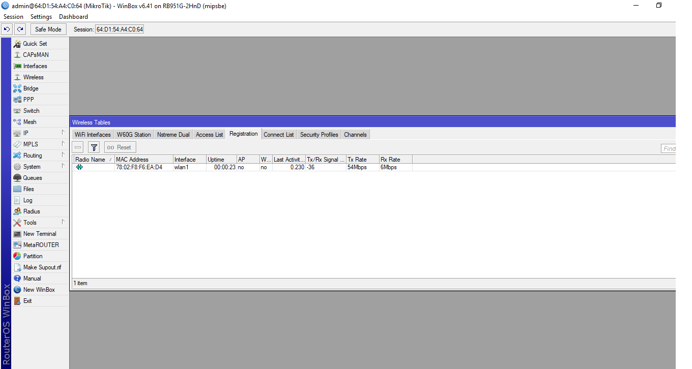

What you see in wireless registration table? Is there max 54Mbit?

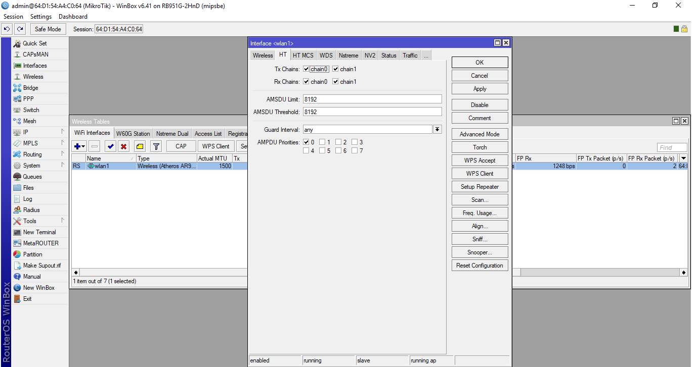

Here are some pictures about the configuration and the wireless interface settings.

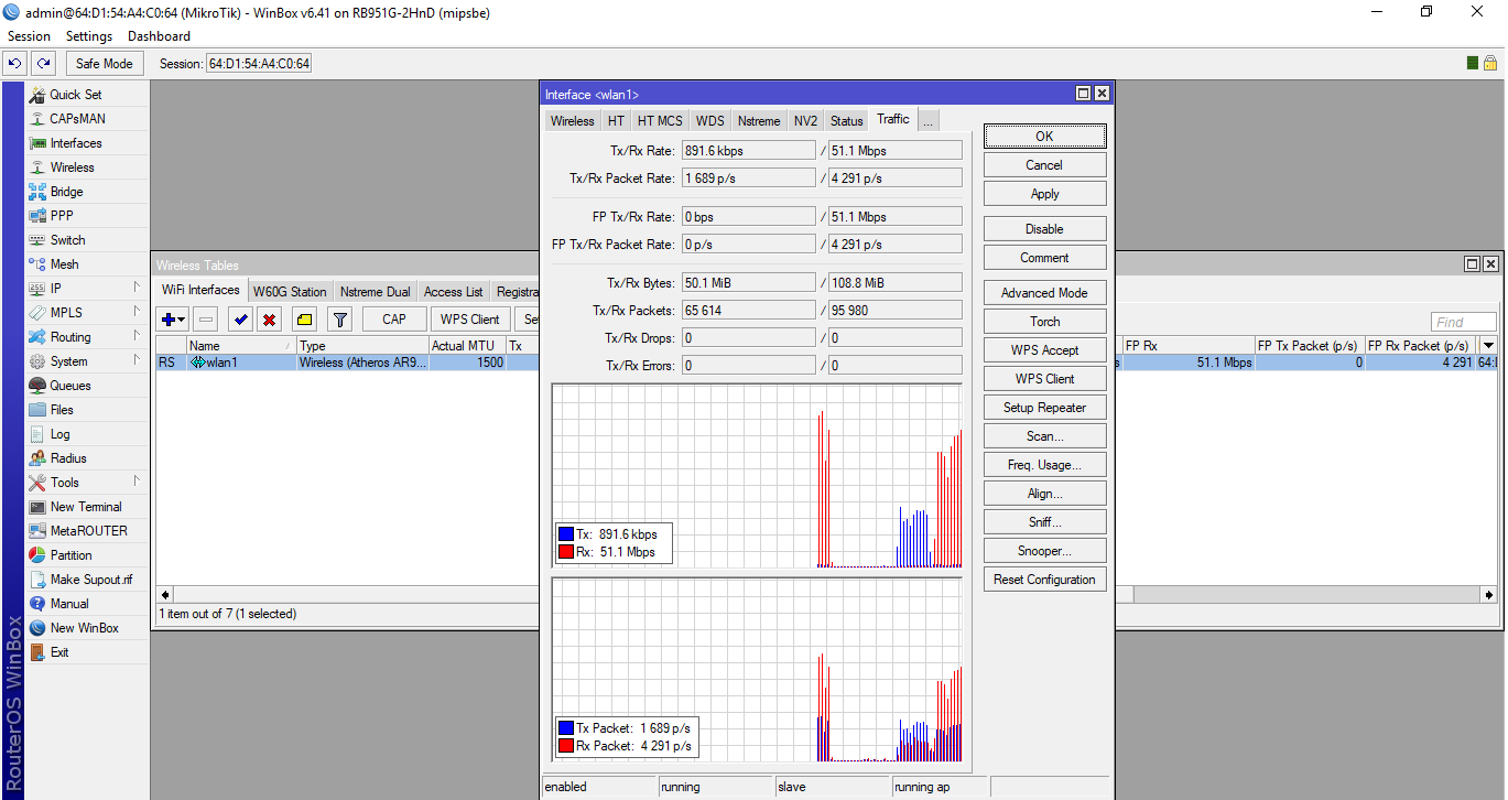

The pictures about Download/Upload are from the same test, I practically get the same speedtest no matter the wireless device.
