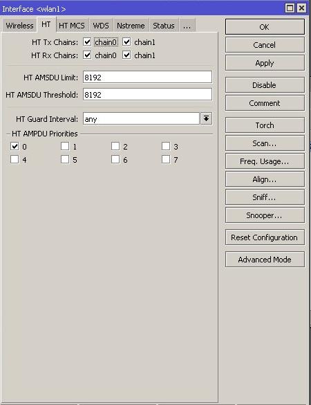

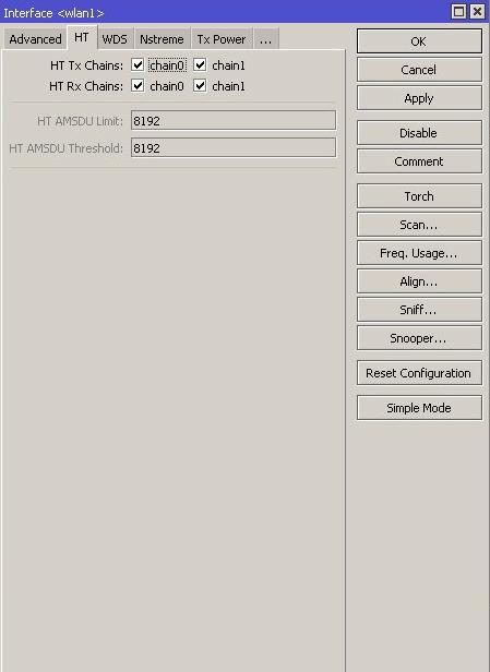

I have customers where I have implemented 5.26 based routers and I did a comparison of the wireless interface settings with some of their MikroTiks and all is identical with the exception of the screen images attached - the customers routers are all running well with wireless speed - since my upgrade/downgrade actions, wireless LAN is still extremely slow despite the default (previously working) values.
The jpg images shows my missing settings (HT guard section) and the customers’ MikroTik also allows the modifying capability in some fields whereas on mine they are greyed out. I may be on the wrong track but this is the only difference that is showing in any of the screens.
