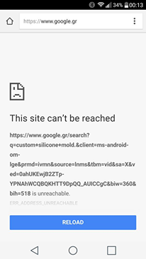

Now the moment i try to deploy the hotspot on either port, (eth3 is the Omnitik and wlan1) with default pool (10.5.50.1 & 10.5.50-2-254) DNS manually entered dns name set as DNS, im still getting the 192.168 range IP over wifi and hotspot never starts and the hotspot server icon turns red and stays red on every port.
The hotspot should be running on bridge between eth3 and wlan bridge in order to have it on both ends?
The physical setup is, DSL router > eth1 of 951, eth3 of 951 to eth1 of Omnitik.
Any ideas? What am i missing here?

Greetings, thanks for your help.
I did what you suggested, reset and apply the script in terminal.
I’m still facing connectivity issues.
As soon as i plug the 951 in the dsl router, and it doesn’t matter if im connected to the 951 or the dsl router over wifi, the internet stops working. It just loads and loads any page.
I also tried to input the ISP DNS just in case but it doesn’t help.
Also i’m not being redicted to the hotspot domain automatically, only if i type it, an even after login nothing changes.
I also tried disabling the DHCP server on the dsl router and enabling a DHCP on top of your config in 951. No success.
Connecting over my phone gives the following page error
Any more suggestions? :frowning:
