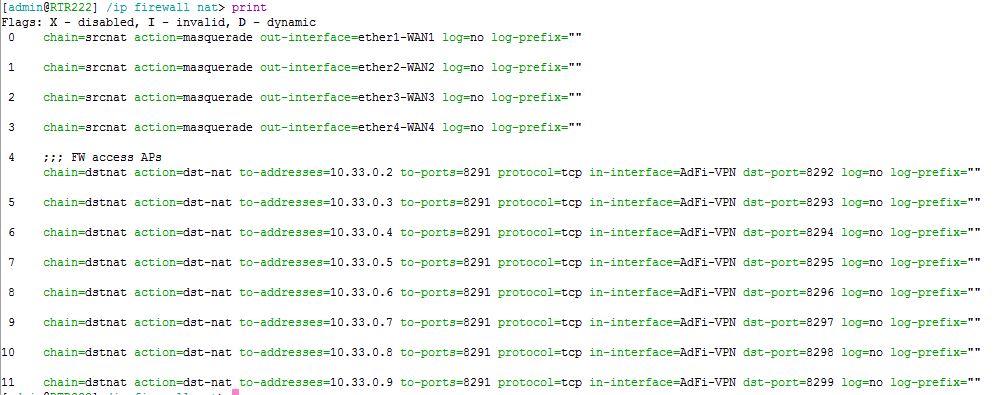

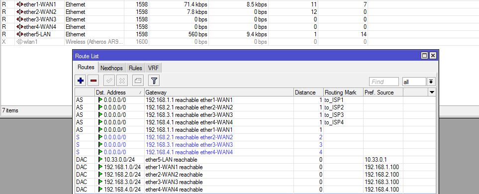

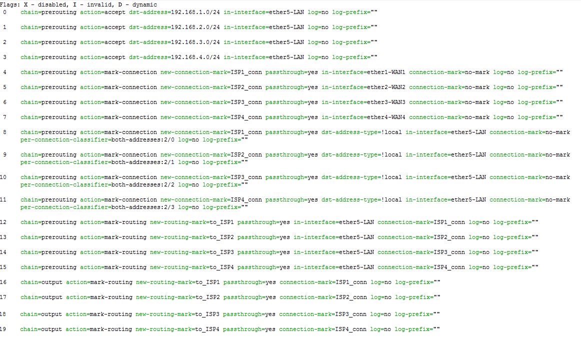

Concerning your problem where two of the DSLs are not trafficking data: Please post ip/firewall/mangle rules. Also post ip/firewall/nat rules. Finally, also post ip/routes.

Here is the info you requested:
Thanks!!
Hello:
In rules 10 and 11 in mangle, under property PCC, you specify 2/2 and 2/3. This is not possible, since the second number is the remainder of a simple division operation. In brief, 2/0 means that the algorithm will divide the number of the connection by 2. if remainder is zero, then the rule is triggered. You will never have division by 2 with a remainder 2 or a remainder 3. Therefore they are never getting triggered. Since you have 4 connections, you need to use 4/0, 4/1, 4/2, and 4/3 in rules 8, 9, 10, and 11 in mangle, under the PCC property. There may be additional problems, but this one certainly would cause the behavior that you describe.
Kind regards,
Yes, looks like that was the problem, now I see activity in the four interfaces with ADSL connections!
Thanks a lot!! :slight_smile:
