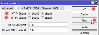

By wireless have you point all the chains on your routerboard?
Yes. At this moment there is RB with firmware 5.26 and all this chains are marked.
I cannot check now configuration for ver. 6.11, but I suppose there are the same settings. In both cases, I have not changed these settings and there are installed values by default.
By the by, in my case, WLANs have been configured but was not used. All devices was connected via ethernet.
