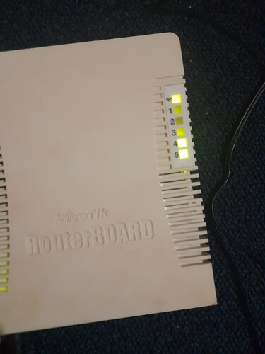

Hello, why is my RB951UI-2HND port4 and port5 has stable green/yellow lights without any connection being made on them. Thanks
Mukisa Nelson
