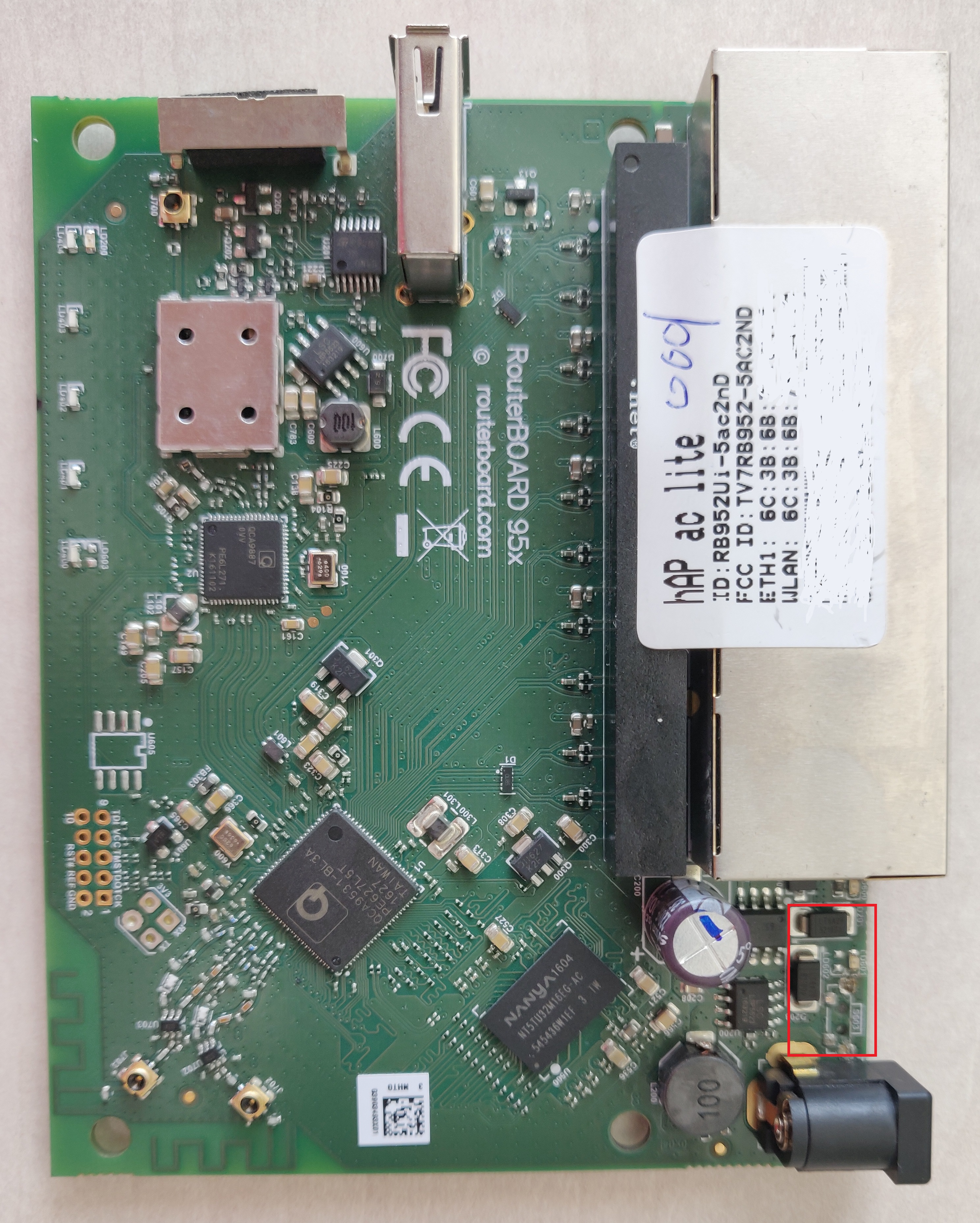

i managed to break off reset button on my mikrotik rb952ui board. is there a way to hard reset board without button? on wiki i saw, that some of the boards have special jumper, but this one don’t have it.
any help would be appreciated.
here is the picture of the board with red rectangle showing where reset button was.
best regards,
Matej
Just connect the pads where button was with a short wire or end of the screwdriver…

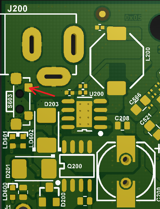

You may try to reset this device by connecting this pin (see attachment) to ground.
