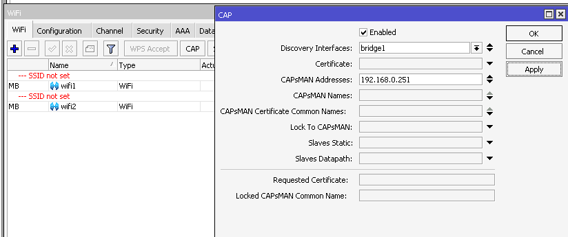

Second bridge is disabled. Here I attach screen of CAP enabled CAP AX

On your interface settings you have it configured as AP.
Not as CAP.
That setting you show is the first step to have it in caps mode but STILL you need to set it on interface as well which one should be used for caps mode.
Currently = ZERO.
That’s why I suggested to reset to caps mode. Then all of this would be ok (and only 1 bridge).

thank you for quick reply. I have no choice to switch it in to cap on interfaceon CAp AX. See attach screen.

Caps mode is enabled to listen on bridge.
Guess what’s not connected to bridge ?
From the last config I see you have no wifi interfaces connected to any bridge.

Thank you very much for your patience with me. I reset to CAPS mode. Now it looks better but wifi interfaces show me (no connection to CAPsMAN).
In WiFi and CAP menu I set up this:
interface/wifi/cap/print
 enabled: yes
  discovery-interfaces: BridgeHome
           certificate: none
  caps-man-addresses: 192.168.0.251
