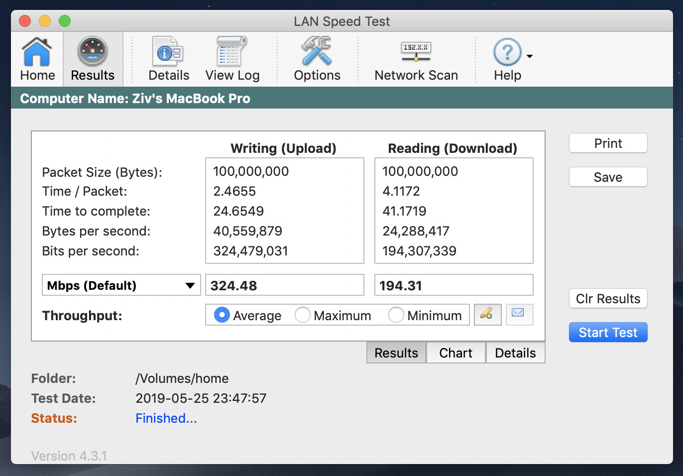

Hi, I have long time Mikrotik equipment but until now I didn’t understand why the wifi is soo week. I have at my home 2 access point (RB962UiGS-5HacT2HnT) distance about 7 meters and the max speed that I’m getting with my MacBook Pro is 300mbps upload and 200mbps download… I had before UniFi AP Pro and with the same computer I got 900+ mbps via wifi…
There is way to improve the performance?
Speed test by write and read file on computer that connected via ethernet

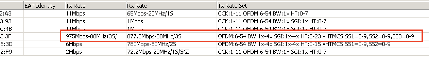

This is the computer from CAPsMAN’s Registration Table
