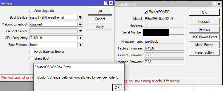

Hi, this router appears unstable, it was not reachable, I asked the client to rebot it and it worked again. Configuration seams ok, it was running 7.15.2 when happened, now I’ve upgraded it to 7.15.3.
Why it displays the CPU is not working ar right frequency? I’m afraid it’s because of that, how can I correct it? Thank you for help
Somewhere in earlier versions it was changed that CPU frequency should be set to auto.
Then the message will disappear.
Thank you I did, the warning disappeared, I hope also the unstability.
I’ve bought it with version 6, and that clock was specified already. That’s something I should keep in mind for next XL
Hi mates, it worked in past but now I can't set more to auto, any ideas? thank you
IA suggests to execute /system/device-mode/update routerboard=yes but I'm not in the place to turn router off. Honestly I don't understand why Mikrotik creates this bug and don't lieave frequency to auto by default, it was never specified
