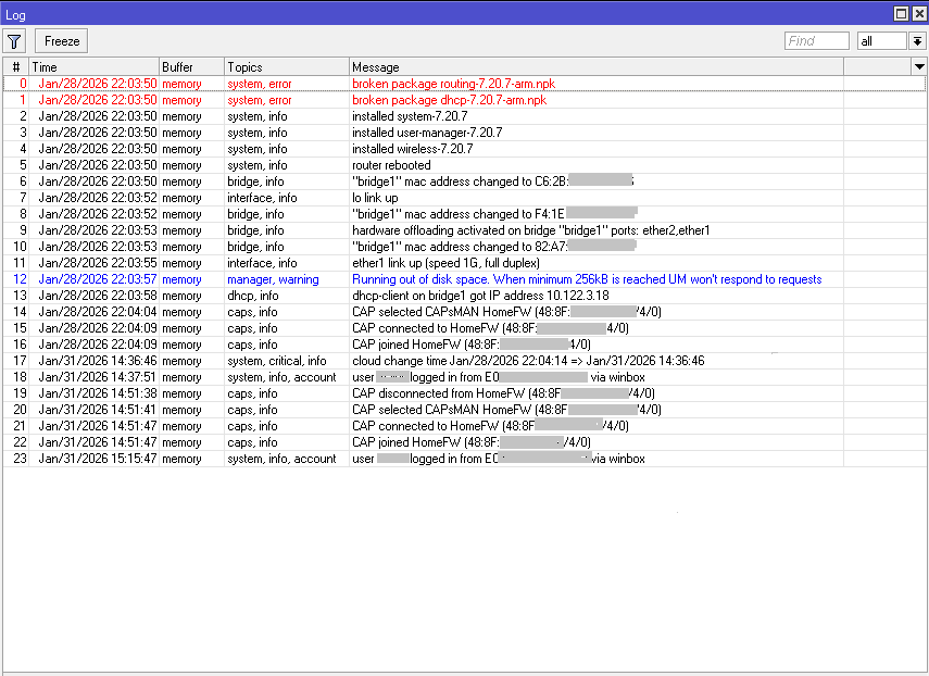

What does the logging say?

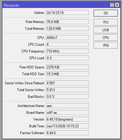

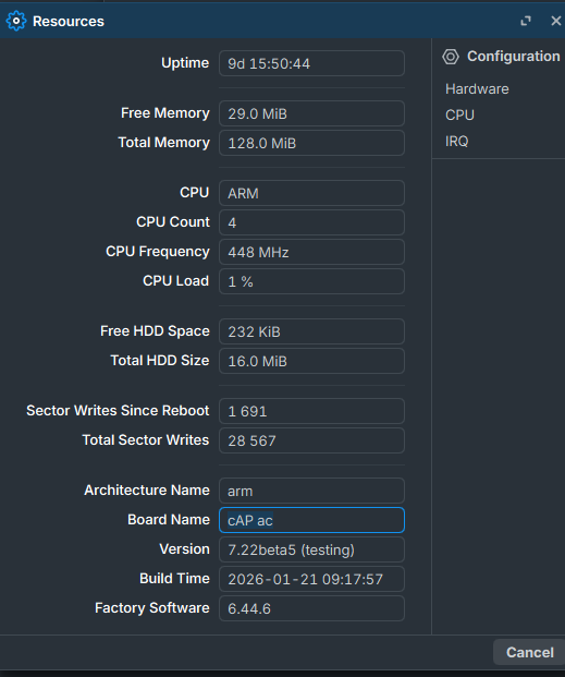

Maybe the storage is all used up?
  1. The firmware currently running is 6.49.19 (long-term).
  2. Wireless (CapsMan management from my central router RB4011iGs+).
  3. Brick = I lose access to the RBcAPGi-5acD2nD because it loses its firmware and I can only see it with Netinstall.
  4. log? How can I see the log since I lose it after the upgrade and can only see it again by reloading the firmware via Netinstall?

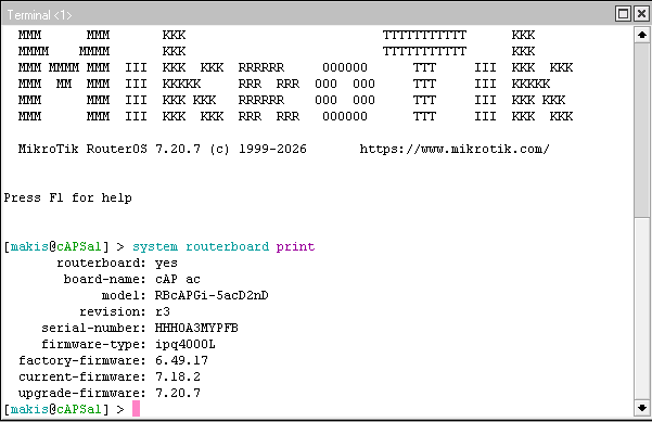

Can you share the output of:
/system/routerboard/print
Well, I tried again today to update, and it worked fine!!!
I don't understand what was wrong, the only thing I noticed was that it took longer to restart.

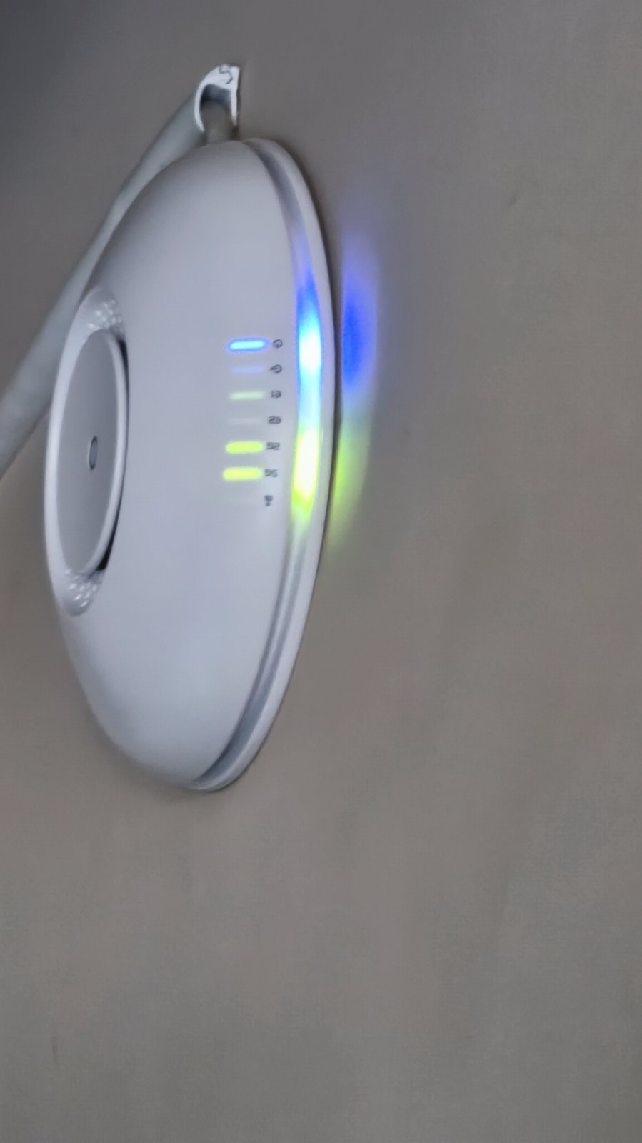

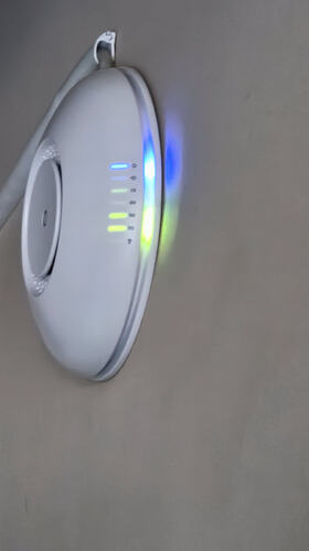

I tried, not once, but 3-4 times, was that after the upgrade it restarted, when opened the LED indicators power and E1 (ethernet 1), I couldn't see it on my network, Winbox couldn't see it, I couldn't see the web interface, the wifi wasn't working either, I could only see it with Netinstall and it only accepted update version 6.49.19, any newer version I tried opened in the same state (power/E1).
Is that device simply hanging from ethernet cable ? :face_with_peeking_eye:
PS personally I prefer square case on that device.
