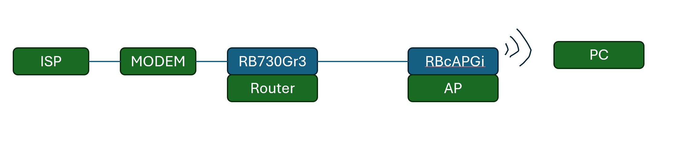

Bridge, because I have main router RB730Gr3 elsewhere, and this RBcAPGi works as AP.
