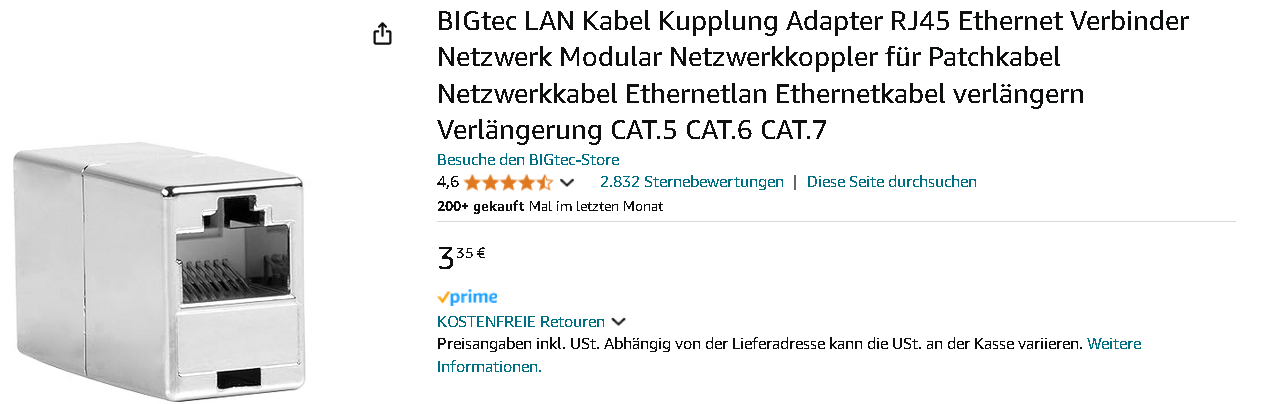

I have messed about with this (the converter is only 8 months old) - and it seems to be the POE injector’s plug…
If I touch it, the ethernet ports light go off and come back on after 2-3 seconds. can you please point out if there is an equivialent part, maybe on amz or something that I can try in exchange?
sooo. its defently the poe injectors plug… not working right on the ethernet socket
I purchased one of these double rj45 socket adaptors and now it works like a charm.
2024-09-28 22_57_42-BIGtec LAN Kabel Kupplung Adapter RJ45 Ethernet Verbinder Netzwerk Modular Netzw.png
