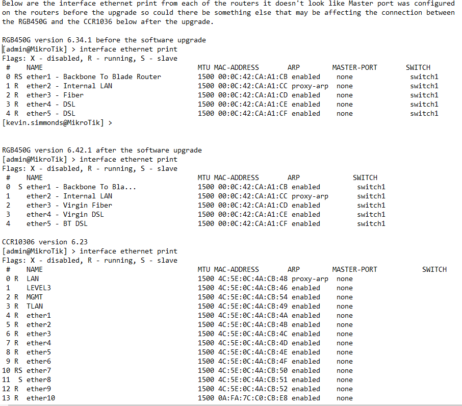

I have looked on the CCR1036 router which this one will be connecting to. If Master port is configured on the routers would it have Master port shown in the config, or would it still be shown as bridge.
https://wiki.mikrotik.com/wiki/Manual:Switch_Chip_Features#Bridge_Hardware_Offloading
Below are the details of the from the two RBG450G one with the upgrade to 6.42.1 and one on the old version 6.34.1 which then connects to the CCR1036 with version 6.23.
None of them have a config for “Master port”
Is there any know issues between the two software versions that may cause the issue, also is there anything else I could look at that maybe causing the issue that I may be missing.
