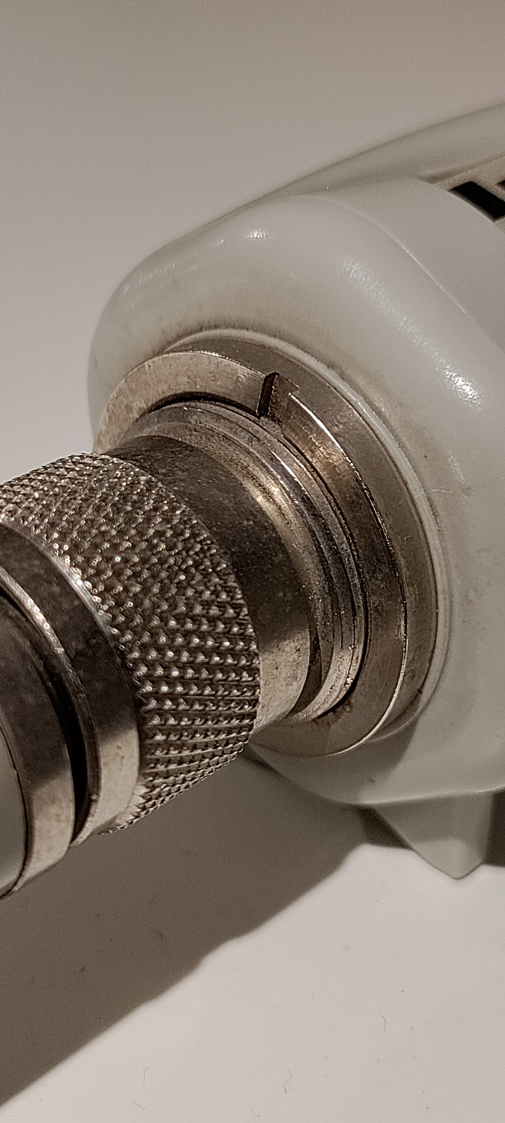

I’ve got a RBGrooveGA-52HPacn which disconnects/resets when I wiggle the ethernet connector (the link disconnect numbers increase etc). I believe the issue to be a dry solder join on the internal network connector joints.
It is out of warranty so I was going to give fixing it a go, but I don’t know the type of tool required to open the ‘Ring nut’ on the top. I think it is some kind of hook wrench but I have no further clues on what I need to buy/do.
Does anyone have any experience on opening a ‘RBGrooveGA-52HPacn’ and what tools are required?

You mean the “ring nut” where the antenna connector is?
Similar to this:
https://www.binder-usa.com/us-en/products/accessories/nuts/01-0010-001-m16-ip67-ring-nut-for-mounting-thread-with-knurled-nut-series-423-425-723
You can use normal pliers on the outside or bent circlip pliers like these (examples):
https://www.betafer.it/en/transmission-tools/14580001-external-butt-ended-circlip-pliers-beta-1458.html
https://www.licotatools.com/product-BENT-CIRCLIP-PLIERS,-INTERNAL-(WITH-SPRING)-APT-38002-SERIES.html
on the grooves.
The tool used in a workshop for those is usually a “sector wrench” or a “compass wrench”, but we are talking of bigger and much more tightened nuts.
What they use in factory is more likely something like this:
https://www.bagnoericambi.it/ricambio-chiave-per-fissaggio-ghiera-x-light-newform-2255500000
