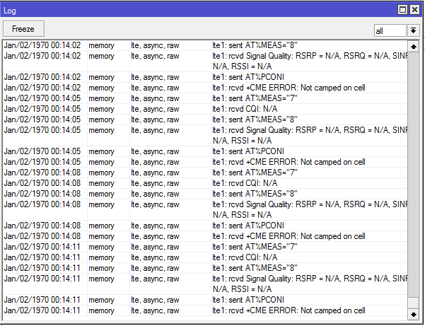

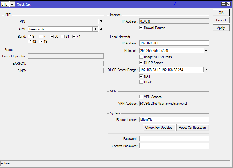

I have LHG4G kit to test with Three uk 4g services however i have no luck with initial set up can anyone offer some advice please ?
Sorry to waste your times i am learning new to this products before i have used only Huawei b315 -b310 routers and they work very well at this location.
I noticed not camped on cell in lte log.
Do i have correct config for three uk APN settings ? Is anyone else using this setup>

You should ask your ISP about proper APN.
I try find it and first result in google give me: https://www.teamknowhow.com/discover/discover/three-apn-settings and answer: APN: three.co.uk

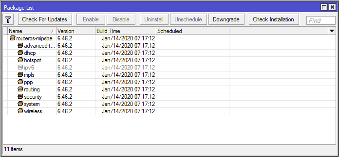

Forgive me i did not make clear which software i was using Currently Last Stable Version 6.46.2 stable with APN = three.co.uk
THANK YOU for some direction i will return to trying new Beta software to see if it resolve my incompetence.

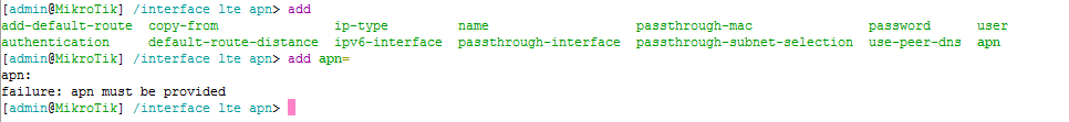

That way:
/interface lte set lte1 !band
/interface lte set lte1 other_option=“”
At screenshot you try add a new apn. Better is use one and the same apn and testing that value who start work with internet.
Example:
/interface lte apn set [find name="default"] apn="three.co.uk" ;
# /interface lte apn print; This give you a number of apn entry
/interface lte apn set 0 apn="three.co.uk" ;

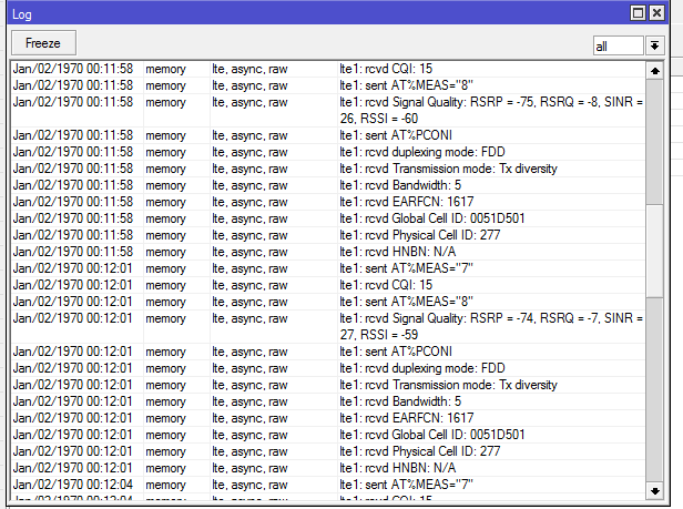

I bought second unit and it worked with basic setup as before ! The only change is hardware, MikroTik LHG 4G/LTE High gain 21dBi CPE - RBLHGR+R11e-4G is original unit i made post about issue not camped on Cell -
Second Unit is MikroTik LHG LTE - RBLHGR&R11e-LTE !
The LTE unit is locked onto band 20 - Band 20 is available on the 4G unit but does not obtain a lock hence original post asking for help.
I will contact vendor as i think its defective unit ?
