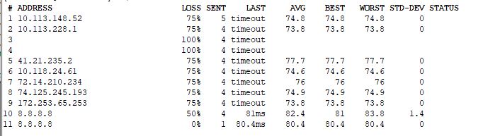

I am getting excessive packet loss on both to example 8.8.8.8, see screenshot below. I don’t know if this is just currently caused by the service providers, but with 2 service providers it seems unlikely. These devices also face different directions, so not sharing a tower, etc.

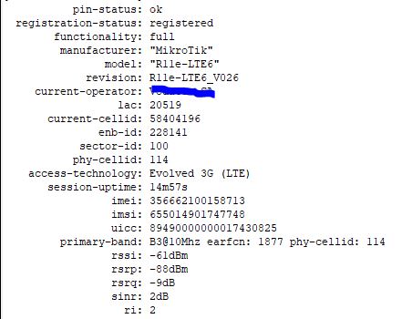

Wait, do you really check the “packet loss” using only 1 ping result ??
I hope you know the LAST HOP in traceroute is proper for packet loss, all prev can drop 100% of icmp and your traffic to end-point can be 100% proper.
If you want show some problem then please give us better feedback, from 25 or 50 pings example.

Your signals in LTE are avr-weak, low CQI not give you a good speed.
No, I did a normal “ping” to 8.8.8.8, had lots of timeouts, just had this screenshot available to post at the time.
Please correct me if I am wrong, then I should see 100% timeouts for each hop, not 75% per hop as in the case of my screenshot?
Important it’s only last one result.
Example for doing traceroute to btest.mt.lv give you:
You can see that Oracle Cloud have not package loose.
Telekom who connect Frankfurt and Riga have no loss.
Some last ISP host give 100% loose.
Last one internet host works properly with 0% loss.
